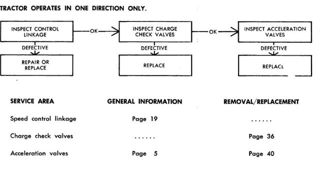

jdmitchjr@6dlam.com 5 #1 Posted April 28, 2015 I have a 1975 D-180 with an ark loader. Bought it used about a year and a half ago and have been fixing it up as needed (mufflers, rebuilt steering box, new spindle bearings, and some other minor stuff) but not doing a full restore. It has been running well and just beginning to earn its keep. It has been running and driving fine. Moved some big rocks, large tree trunks, and 13 year old daughter drive it around the yard for about two hours -- all seemed good. Today, moving mulch around, after about an hour and a half, it stopped going forward. Reverse is fine. If the lever is pushed all the way forward, it will creep forward on level ground and it whines. If the lever is pushed all the way forward and a human pushes just a little bit, it goes forward easily and the whining stops. It almost seems like it wants to go forward. Since it goes in reverse fine and there is no awful mechanical noise when it tries to go forward, I think the coupler is fine. The transmission fluid level is routine checked and was checked when the problem arose. It is resting now and I will check the fluid level again. It does leak from the case split. Perhaps it is low and the whine is fluid starvation. Any thoughts or suggestions would be appreciated. I am new to these hydro pumps and transmissions.... Thanks. Regards. John Share this post Link to post Share on other sites

pfrederi 21,306 #4 Posted April 28, 2015 (edited) I would download the Sundstrand manual from here. First check would be the linkage Edited April 28, 2015 by pfrederi Share this post Link to post Share on other sites
jdmitchjr@6dlam.com 5 #5 Posted April 28, 2015 Thanks. I checked the linkage and it appears to be fine -- nothing broken, nothing disconnected, nothing hanging free. And it seems like it is activating the transmission to drive forward, just no power. I have the Sunstrand manual and landed on the page you posted from. But I am having trouble understanding from the manual how to field check the two valves. It seems to me that the unit needs to be pulled out and apart to check. Any suggestions on doing it without pulling the unit and what to look for? Also, this may seem like a really dumb question, but I was under the impression that the fluid in the transaxle is the same fluid reservoir for the hydro system. Is that correct? Is there another place other than the transaxle dipstick to check fluid level and/or fill the hydro unit? And anyone out there have a rebuilt or known working hydro pump and motor for sale? Or does anyone do rebuilding? I am not sure I have the time to do it myself. Thanks. Regards, John Share this post Link to post Share on other sites
