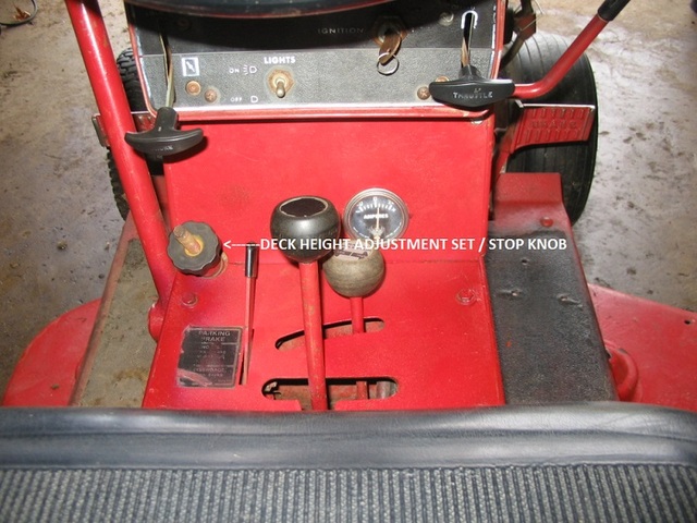

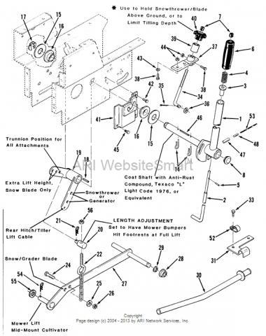

daveoman1966 3,884 #2 Posted April 24, 2015 Your 314-8 should have this deck height adjustment stop / set knob. Raise the deck by the hand lever to about where you want the grass height, then turn the knob to set that position. If that isn't enough, look underneath and reset the chain link length by turning the trunion (20) on the threaded eye-bolt (22). If that still isn't enough maybe reset the trunion in a different hole of the rock shaft (19). Share this post Link to post Share on other sites

daveoman1966 3,884 #5 Posted April 24, 2015 The 2nd part of my reply was: If that isn't enough, look underneath and reset the chain link length by turning the trunion (20) on the threaded eye-bolt (22). If that still isn't enough maybe reset the trunion in a different hole of the rock shaft (19). So, look up under the left side foot rail and you should see the long lever (27) hanging down, with a chain connecting to an eye-bolt (22). You can either shorten the chain connection by turning the trunion (20) further onto the threads of the eyebolt (22), OR... unbolt the chain from the lift bar (27) and bolt to the next chain link ..OR... move the trunion (2) further to the end of the rockshaft (19). 1 Share this post Link to post Share on other sites
