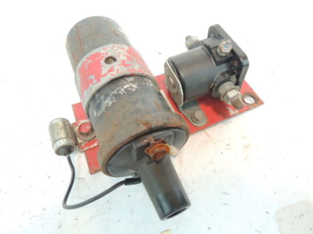

lordzoltron 0 #5 Posted April 25, 2015 set-up looks like this (pic from E-Bay not my tractor) Share this post Link to post Share on other sites
gwest_ca-(File Mod) 12,324 #6 Posted April 26, 2015 If your coil looks like that it is battery ignition. Where are you getting the 10 volts? There should be battery voltage at the coil (+) terminal only when the key is in the RUN or START position. Should be 0 volts with the key OFF. Garry Share this post Link to post Share on other sites
lordzoltron 0 #7 Posted April 26, 2015 (edited) I get a steady 10V from the plug wire with ignition off... then drops to 0V when cranking... ignition makes more sense to me than a coil going bad just sitting through the winter. Was running find last time I shut it down in the fall. Edited April 26, 2015 by lordzoltron Share this post Link to post Share on other sites
