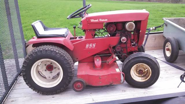

Tdfleischer 12 #1 Posted April 22, 2015 Good evening, My name is Tim. It's my first time on this forum, and hope to learn a lot from you experts. I have been handed down a 50 year old WH 855 by family, which appears to be in very good shape. It hasn't been run in a few years, but properly winterized and taken care of exceptionally well. I have a friend who can help me get her in working order, but im not sure where to start, where to find parts and how to find a local expert (central Ohio). These items have been recommended so far: points (I don't know what that means), plug, condensor, air filter, oil, grease zerks, clean the carburetor, sea foam fuel system cleaning and a fuel additive since our new fuels are tough on old systems...are these items all accurate? What else must I do/check/replace? All advice regarding the above topics, plus estimated total cost would be greatly appreciated. I am just a horticulturist, far from a mechanic, and want to truly understand my new machine. Thank you kindly, Tim 6 Share this post Link to post Share on other sites

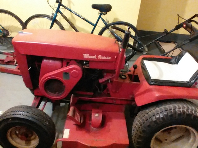

Tdfleischer 12 #2 Posted April 22, 2015 Here is a better quality pic. I also received the original snowplow attachment. 6 Share this post Link to post Share on other sites
Ed Kennell 47,818 #3 Posted April 22, 2015 That is a great looking Wheel Horse. You may want to also check the belts and replace if they are worn or cracked. Welcome to Share this post Link to post Share on other sites
BESTDOGEVER 218 #4 Posted April 22, 2015 All the items you listed are standard tune up items most should be available at your local toro dealer or online from places like parts tree. Points and condenser can be cleaned and set to specs if they aren't worn out .The fuel you use should never have more than 10% ethenol more than that will ruin the seals in the carb or fuel pump. Change the oil and transmission oil regularly and you should have a great machine for years to come. Welcome to the wheel horse family. Share this post Link to post Share on other sites
Retired Wrencher 7,036 #5 Posted April 22, 2015 (edited) WOW Tim that is very nice. It looks like they took care of it. I would buff up the paint and clean any grease or oil areas and call it a day. Lot of parts on E-Bay if needed. we can help with part #`s. I would have the seat repadded. enjoy the ride. Gary B. Edited April 22, 2015 by T1257 Share this post Link to post Share on other sites
953 nut 70,330 #6 Posted April 22, 2015 Always glad to hear of a being passed down within the family, especially a real nice one like yours. I would go one step further than BESTDOGEVER when it comes to fuel, use ethanol free gas only! Go on line to buyrealgas.com and put in your zip code, it will tell you where you can get ethanol free gas. Before you do a lot of work I would charge up the battery, pull the spark plug, crank it over and see if you have spark; if you do then put it back in (or replace it with a new one) add gas and it will probably run fine. Good luck and keep us posted. Share this post Link to post Share on other sites
BESTDOGEVER 218 #7 Posted April 22, 2015 That's a good point 953 Nut if you live anywhere that has marinas you might find it there reasonable. Also you do have a great looking horse there and hopefully you can pass it along to your kids. Share this post Link to post Share on other sites
KC9KAS 4,746 #8 Posted April 22, 2015 Thanks for the photos. Glad you found us. Share this post Link to post Share on other sites
jackhammer 553 #9 Posted April 23, 2015 That is a nice looking tractor, welcome to RedSquare Give yourself this summer to adjust and you'll be quite happy with yours Share this post Link to post Share on other sites
