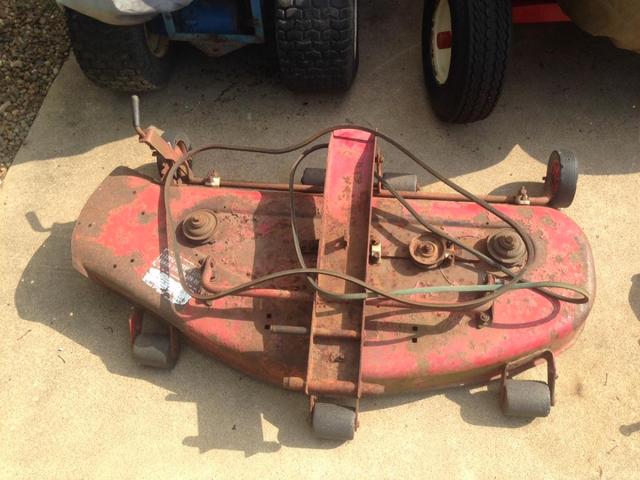

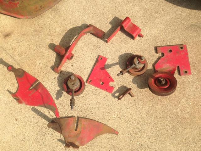

tractorchick 401 #1 Posted April 22, 2015 Help me! Here is a picture of the deck and the parts for the deck. This is going on a 1969 Raider 12. How the heck does this work????????? Does someone have a good photo or diagram of how I need to put this on the Raider? Please and thank you- Kate Share this post Link to post Share on other sites

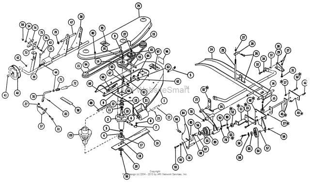

daveoman1966 3,884 #2 Posted April 22, 2015 This is a most unwieldy apparatus ever designed....accordingly, almost impossible to describe how to put it together. You only need one of the half-moon shape parts and onlyu one of the idler pulleys that have a 'stem' on it. I will try to chase down some schematics that should help.... my direct email is: daveoman@fwindstream.net contact me there as it is much easier for me to send pics and stuff in regular emails. 1 Share this post Link to post Share on other sites
daveoman1966 3,884 #3 Posted April 22, 2015 here is a schematic of the 42" side disch deck. 1 Share this post Link to post Share on other sites
tractorchick 401 #4 Posted April 22, 2015 HOLY CRAPOLA^^^^^^^ Wow oh wow! I'll print it, study it, take a deep breath,and give it a whirl, Daveoman! Let me know if I can ever return the favor. Many thanks! Kate Share this post Link to post Share on other sites

Don1977 606 #7 Posted April 22, 2015 I couldn't help with mounting that as I have later models. I did see the latch for the "Speed Hitch" was missing from your parts. Click on hitch and lift link speed hitch and look for Part no. 7-01 http://www.partstree.com/parts/toro/mowers-lawn-garden-tractor/1-0100-toro-workhorse-800-tractor-1971/7-000-hitches-and-lift-linkage Share this post Link to post Share on other sites

Racinbob 13,286 #10 Posted April 23, 2015 It really isn't that much different than the later style as far as how the mower mounts. The drive off the PTO has a few more parts but it's pretty straight forward. If you had a front mule drive on your tractor the newer style belt setup will work but you don't have that. Being handed a box full of parts can be overwhelming but just reassemble one part at a time as you study the drawing and before you know it you'll have it together. Share this post Link to post Share on other sites

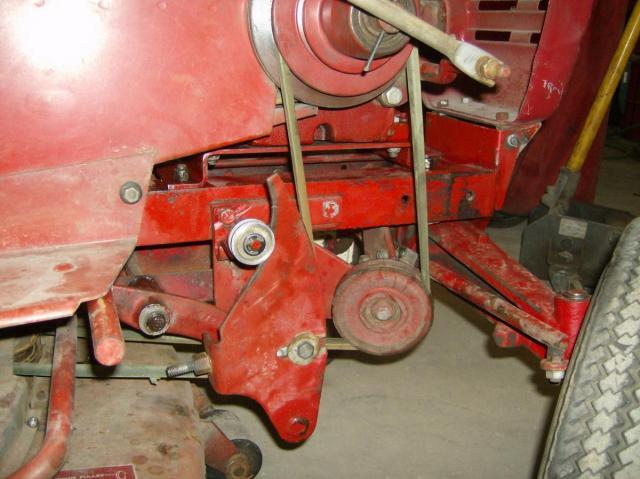

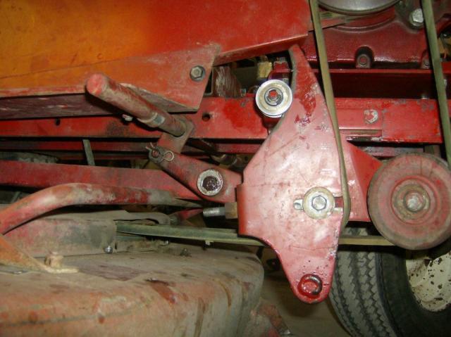

ol550 879 #11 Posted April 23, 2015 (edited) These pics may help. I don't see the roller for the tension cam. Had to make the roller on mine as it is rather expensive new. And had to see if I could. Edited April 23, 2015 by ol550 2 Share this post Link to post Share on other sites
Racinbob 13,286 #12 Posted April 23, 2015 Excellent ol550 Share this post Link to post Share on other sites
