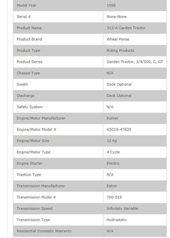

daveoman1966 3,884 #2 Posted April 21, 2015 Toro site says the 312-A has the Ekaton 700 series unit...here is a snipe Share this post Link to post Share on other sites

Aussie 108 #6 Posted April 22, 2015 as shallowwatersailor pointed out, the Eaton 700 has a separate fluid supply to the rear axle, unlike the 1100 which utilises the rear axle fluid. There is no provision for draining the 700 fluid on the machine, other than removing the plastic reservoir, which will only get a portion of the oil out. If you wanted to change the transmission fluid you would have to remove the 700 from the tractor and turn it upside down and rotate to get the fluid out. Share this post Link to post Share on other sites
shallowwatersailor 3,222 #7 Posted April 22, 2015 (edited) I was mistaken about the location of the drain. A dealer told me there was and I misunderstood about the location. It is actually the hex head screw on top. Here is a procedure to replace the fluid on an Eaton 700 with a Peerless 1320 tranaxle. The procedure is to remove the screw and pour fresh oil into the reservoir and force the old fluid out the bleed. Bring the fresh fluid to the correct level in the reservoir, raise the rear end (safely) and rotate the rear by disabling the engine for starting. Then crank the engine to remove any trapped air. If it makes any noise there is still air in the system. After looking at the Toro parts site, it appears that the bleed screw hole is used for the reservoir on a 312-A, so Aussie would be correct. Other than the linkage, it is self-contained and should be easy to remove to drain upside down. https://lookup3.toro.com/partdex/index.cfm?xCaller=Toro Enter "312-A". Edited April 22, 2015 by shallowwatersailor Share this post Link to post Share on other sites
