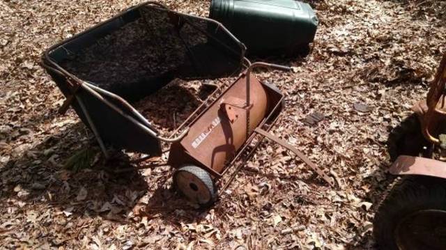

JPWH 6,544 #1 Posted April 20, 2015 I have been wanting an 854 and seen this ad on cl and it was close so... I took a little road trip to look at it and four hours later I was home with this in my pickup. Now I have to decide whether to leave as is, part out or restore. 3 Share this post Link to post Share on other sites

KC9KAS 4,746 #7 Posted April 20, 2015 And you got a sweeper too! Save 'em! Share this post Link to post Share on other sites
stevasaurus 23,662 #8 Posted April 20, 2015 I vote to save it...it is not in too bad of shape. I love the seat. LOL Share this post Link to post Share on other sites

953 nut 65,321 #10 Posted April 20, 2015 Considering the fact that it is very complete and not too bad looking I would get it running and see about getting a good seat and drive it as is. Survivors are very popular now and you could always do a restoration in the future. That lawn sweeper is a keeper, needs some TLC, but they are hard to find. 1 Share this post Link to post Share on other sites

JPWH 6,544 #13 Posted April 21, 2015 I had a little time to look it over good this afternoon. I couldn't look too much yesterday because it was raining something awful and there was tornado warnings where I was. I figured I couldn't go wrong for a hundred bucks so I paid the man and watched him and his buddy load it and I proceeded to get ahead of the storm.Now that I look at it the transmission is locked or rusted up the spark plug is missing and the motor wont turn. The motor tins are rotten and the hood needs some repair. The mower deck won't turn and the wheels on the leaf sweeper won't roll. All considering I am real fortunate to find an 854 of any condition in Ga. I think maybe with a little pb blaster, blood sweat and tears, a little guidance from some of you experts, anything is possible. I don't have some of the tools that would make it easy but I have enough to make it interesting. 1 Share this post Link to post Share on other sites

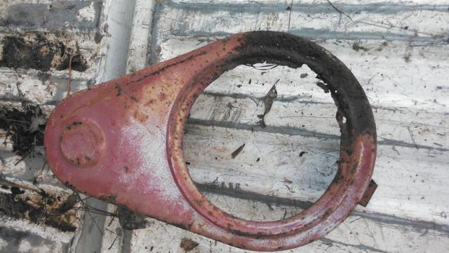

JPWH 6,544 #21 Posted May 5, 2015 (edited) Any suggestions how to repair this or is it too far gone? Edited May 5, 2015 by Hank01 Share this post Link to post Share on other sites
JPWH 6,544 #22 Posted May 5, 2015 (edited) Any suggestions how to repair this or is it too far gone? I can cut and weld the flat area but not sure about the raised portion of the circle. Edited May 5, 2015 by Hank01 Share this post Link to post Share on other sites
bmsgaffer 2,071 #23 Posted May 5, 2015 I don't think the generator belt guards are too hard to find for the 854 (unlike the 701), so I don't think they are very expensive. I do know that I would have no way of doing that without finding a real experienced metal fabricator, so I would just look for a replacement. Share this post Link to post Share on other sites
stevasaurus 23,662 #24 Posted May 5, 2015 Glad to see you are diving in. I have a suggestion on the trans that you could do and it will not take too much time. Drain the trans. Fill with diesel fuel (take off the seat and fill through the holes in the top of the trans). Fill it up to the top (between 1/2 and 1 gallon) and let it sit until you are ready to open it up. Make sure you put like one of those turkey, tin foil pans under the trans..a large one. The seals are probably dried and the diesel may leak out. That's OK...just dump what drips out back in. This will help to loosen things up if everything is rusted...and it will stop the rusting. Share this post Link to post Share on other sites
