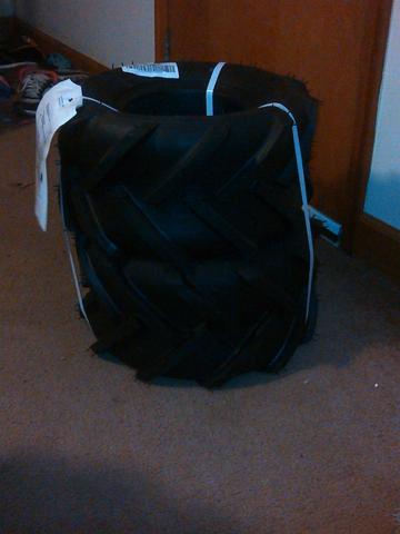

geod919 12 #2 Posted May 11, 2015 Ended up ordering some Carlisle super lugs in factory size. Will see how they run soon. Kind of excited. While doing research I've decided I want to get tri ribs for the front. Deestone makes a 3.50x6 that's about 3/4 of an inch taller. It's unfortunately a bit narrower too, so I'll need to source some 3" wide wheels. Does anyone know of a wheel that will fit without modification? 1 Share this post Link to post Share on other sites

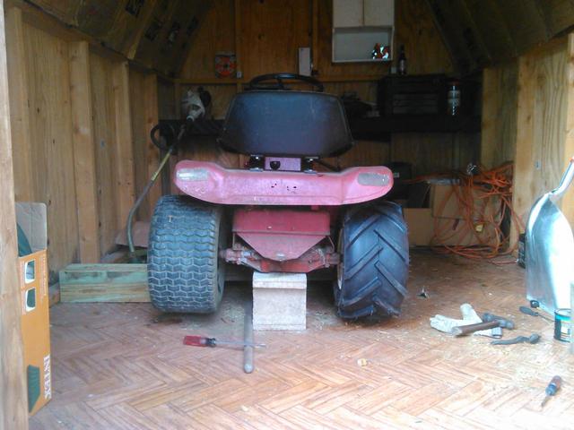

geod919 12 #17 Posted May 12, 2015 Man this left hand wheel is on there GOOD. Any recommendations? It's the keyed, e clipped style. Share this post Link to post Share on other sites
geod919 12 #18 Posted May 12, 2015 Getting there. 1 Share this post Link to post Share on other sites
steve k 82 #19 Posted May 13, 2015 Last time I put tires on my 211 I ended up just changing the tire on the wheel while on the tractor......It was easier than getting the wheel off! 1 Share this post Link to post Share on other sites
geod919 12 #20 Posted May 13, 2015 That's what I'm doing now, too. Share this post Link to post Share on other sites
