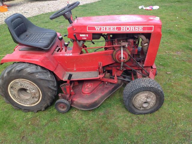

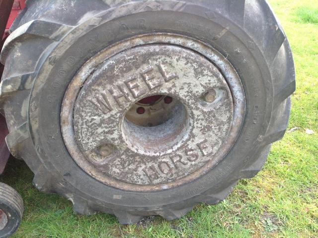

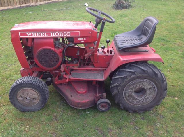

neil 2,415 #3 Posted April 17, 2015 I recently purchased this tractor and these weights were already on the tractor , so I would also like to know the difference between the two 5 Share this post Link to post Share on other sites
Racinbob 13,005 #4 Posted April 17, 2015 Al, personally I think it's all in what you'd prefer to do. Up north a friend brought me two solid chunks of steel (no hole in the center) just the right diameter to fit fully inside the rear wheels and about 5" thick. They weighed 88 lbs each and did a great job on my C-160. If I were to fill the tires I definitely would use tubes like you. Neil, those are some awesome weights. I've never seen weights like that before. 1 Share this post Link to post Share on other sites

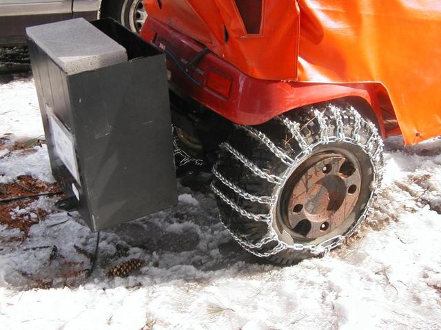

JackC 619 #10 Posted April 18, 2015 I like having wheel weights and a ballast box on the back that I can remove when I do not need the weight. Share this post Link to post Share on other sites

cheesegrader 436 #18 Posted April 18, 2015 I have the ags on my loader filled with Rimguard, and have an additional #88 of weights bolted on each rim. I ALMOST never need the weight box with this set-up, which is nice, because the loader is long enough to present some problems moving in tight spaces, and an extra "16 of weight box on the back end only makes things worse. My other tractors have bolt-on weights only. It is nice to be able to take the weight off for the tractors that run on the grass in the summer. I don't think the wear issues differ much between fluid filled tires or Weights on the rim, although I would think that torque from a spinning, fixed weight would be higher than torque from rotating fluid. Physics gurus feel free to chime in here. At least the load in those setups is on the ground. Weight boxes hanging off the frame are another story. I have always wondered if that setup would damage the rear bearings over time. 2 Share this post Link to post Share on other sites
