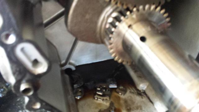

plumber 1 #17 Posted April 18, 2015 (edited) Well, I found the drain for the transaxle, the plug is taking a Kroll soak right now. On to bigger issues. I had a coolant leak, and when I pulled the water pump I heard that lovely sound of something dropping inside the motor! Turns out the water pump gear was in about 6 pieces. Edited April 18, 2015 by plumber Share this post Link to post Share on other sites
