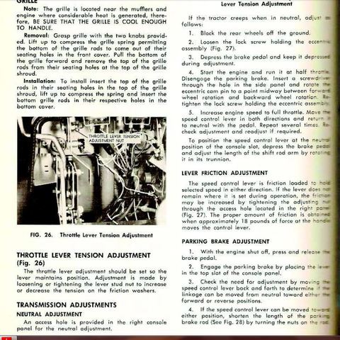

rpilote 20 #1 Posted April 16, 2015 Hi, I now have my D180 running strong, and the hydraulics are working fine. I need to know what the procedure is for adjusting linkages and adjusting for "creep" when in neutral position. I assume there is a procedure that needs to be followed..Thanks in advance, Rich Share this post Link to post Share on other sites
pfrederi 21,274 #2 Posted April 16, 2015 Check out the owners manual ...you can download it here. Share this post Link to post Share on other sites
