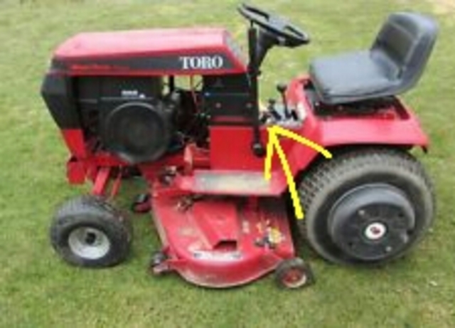

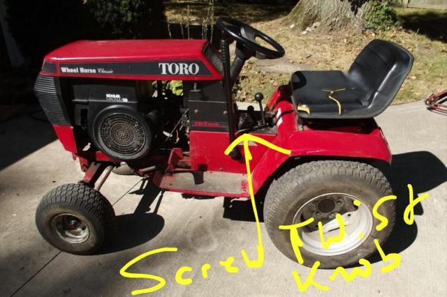

ibskot 37 #4 Posted April 13, 2015 I have 2 decks. One is a rear discharge and the other is a side. I think I will try the side discharge first. Both are 42 inch. Do I have to have the little screw thing in these pics to use the deck correctly? I have have what may be called a "frankenhorse"...so I don't have that. This tractor in the pic isn't mine. Share this post Link to post Share on other sites
gwest_ca-(File Mod) 12,533 #5 Posted April 14, 2015 The tractor you posted is 1990 or newer because it has the black hood decals. The one in your avatar is 1985-1989 - maroon decal Side discharge deck Rear discharge deck These decks should match what you have as far as installation and belts go. There can be differences in the blades and bearings as these changed over the years. You do not need the height adjustment knob for the lift lever to use the mower deck. That is more for a dozer blade or mid-mounted grader blade. Garry Share this post Link to post Share on other sites
