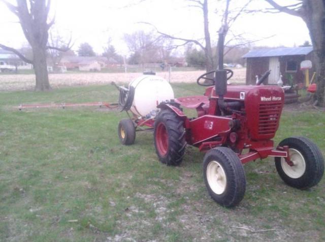

Dieselcowboy 211 #1 Posted April 13, 2015 Where could I find how fast a stock tractor goes? I'm wanting to spray with one of my horses and need to be in the 4.5 - 5 mph range Share this post Link to post Share on other sites

Dieselcowboy 211 #5 Posted April 13, 2015 My top choice to use is a 753 4 sp next is a C160 auto or a b-80 4 sp Share this post Link to post Share on other sites

Dieselcowboy 211 #11 Posted April 15, 2015 Here is what it will be. The 753 2 Share this post Link to post Share on other sites
