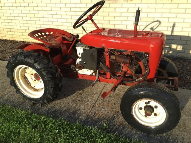

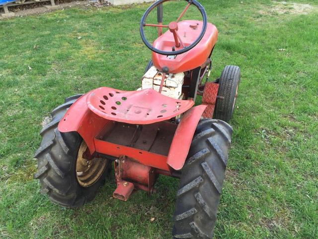

JeffreyLKY 43 #1 Posted April 12, 2015 Would anyone be able to help me identify a recently purchased RJ or Suburban tractor? The only identifier I can find is near the shifter, and that says J11-1. The original motor was apparently removed some 15-20 years ago, and there seems to be no frame label or ID on the tractor. This model does have the seat with storage underneath, the small rear fenders, and no louvers in the hood. Perhaps a Suburban? Thanks for any information...can't seem to locate in manuals and so forth with my limited knowledge and information on the older units. Thanks!! Share this post Link to post Share on other sites
Lane Ranger 12,161 #2 Posted April 12, 2015 If the J-11-1 is on the top of the transmission that would be a code for the year it was made. October-11- 1961 Post a photo 0f your tractor and you will get plenty of information ! Share this post Link to post Share on other sites
Sparky-(Admin) 26,688 #3 Posted April 12, 2015 Maybe a 701? Was the motor under the hood or between your legs? I believe the last year of the solid grill without slots was 1961. Mike........ Share this post Link to post Share on other sites
Jake Kuhn 1,600 #4 Posted April 12, 2015 Sounds like a 61 model so a suburban or 701 as others have mentioned. Post some pictures and we can let you know for sure. Share this post Link to post Share on other sites

Racinbob 13,286 #10 Posted April 12, 2015 (edited) You have a 1960 Suburban Jeff. That's what I'm in the process of restoring right now. My date code on the transmission is C1-0 Edited April 12, 2015 by Racinbob Share this post Link to post Share on other sites
Racinbob 13,286 #11 Posted April 12, 2015 (edited) It's a very nice example but some odd things have been done. Of course the engine is wrong but at least the hood wasn't cut up like so many are with an engine swap.The idler should lift up on the belt and not push down, The clutch spring is hooked up wrong. It should pull forward on the cross shaft lever that the end of the clutch rod is connected to. A few other odds and ends. All in all it's a great one to restore or fix up mechanically and have fun with. With the transmission code it may have been put together with 60 ans 61 parts. No harm done there. Edited April 12, 2015 by Racinbob Share this post Link to post Share on other sites
953 nut 70,330 #12 Posted April 12, 2015 At some point the hood or the transmission may have been changed out, it is a 1960 hood and a 1961 transmission. That being said, you have a fine looking Suburban and any of us would be proud to have it in our herd. Lots of us have minor mismatched parts on our and that is fine, we are here for the mutual enjoyment of our hobby. Enjoy the ride and keep us posted as you go. Share this post Link to post Share on other sites
Jake Kuhn 1,600 #13 Posted April 12, 2015 Looks like a pretty nice little tractor, however the trans has a few odd things about it. First off, the brake band mount is the setup for the rj, and also uses the rj style pedal, this would of been used on 58 and 59 models, and the casting date is 61, I would guess that probably someone had the trans apart at some point, or maybe took 2 tractors and built them into 1? This doesn't harm anything, just kind of a interesting modification. Share this post Link to post Share on other sites
AMC RULES 37,260 #14 Posted April 12, 2015 Nice score... hard to find one that hasn't been messed with at some point. Share this post Link to post Share on other sites
Racinbob 13,286 #15 Posted April 12, 2015 Good eye Jake! I didn't catch that. So you're thinking sides from a 5003 on a 5010 case? I don't see why that wouldn't work but I'm no guru here. Share this post Link to post Share on other sites
