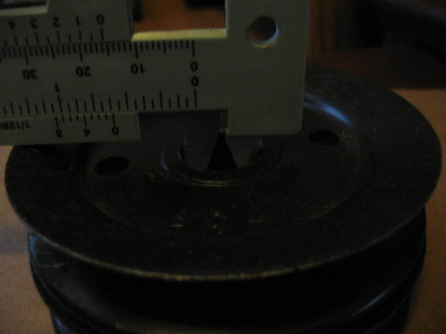

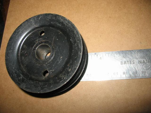

daveoman1966 3,884 #7 Posted April 11, 2015 (edited) I may have just the thing you want, if increasing tip speed is your goal. This is a double-pulley for the center spindle and it is only about 3" diameter on the TOP and BOTTOM of it. Usually, the top section is 4" or so, and the lower V pulley is 3" (estimates). This pulley is the SAME on top and bottom. Here is a pic... For more info, send an email to me here: daveoman@windstream.net Edited April 11, 2015 by daveoman1966 Share this post Link to post Share on other sites

daveoman1966 3,884 #9 Posted April 11, 2015 (edited) I will also measure that top & bottom dia of the double-pulley I have.... I know it is the SAME on top and botrtom. Please contact me by DIRECT email at this address: daveoman@windstream.net Edited April 11, 2015 by daveoman1966 Share this post Link to post Share on other sites

daveoman1966 3,884 #18 Posted April 11, 2015 The double pulley I have is 3 3/8" dia on top AND bottom V grooves. The center shaft if 5/8" diameter. Here are a cupld pics... Me thinks the original top pulley is 4 1/4" dia and the lower one is 4" dia...not sure. In any case, this smaller 3 3/8" pulley here will definitely increase the tip speed. Share this post Link to post Share on other sites
