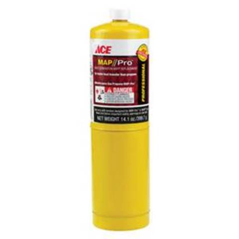

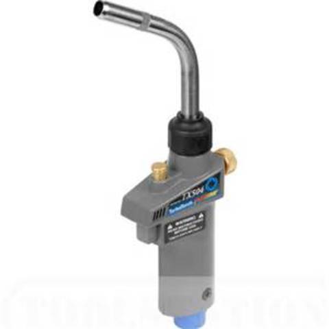

squonk 44,859 #3 Posted April 10, 2015 If you really don't want even the little mini HVAC Oxy/Act setup another option is a hand trigger Turbo Torch with the Mapp/Propane mix 2 Share this post Link to post Share on other sites

Ken B 3,202 #6 Posted April 12, 2015 For most things all you will need is what Squonk showed you... Cheap yet very effective. 1 Share this post Link to post Share on other sites
