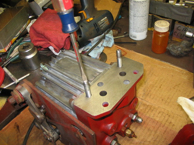

daveoman1966 3,884 #2 Posted April 6, 2015 Is the PUSH / TOW valve open.... Turn clockwise to CLOSE it. Are there any seeps or leaks where the 4-line manifold connects to the PUMP or the HYD MOTOR at the rear end gearbox? I have rebuilt several of these hyd pump / motor separated systems in the past and the O-rings can be a PITA to get right. There is a method to keep them aligned and described in the manual that you can download....look in the manuals section of Red SQ. It describes how to make studs to align the O-rings and hold them in place. Here is a pic of the studs I use. Share this post Link to post Share on other sites

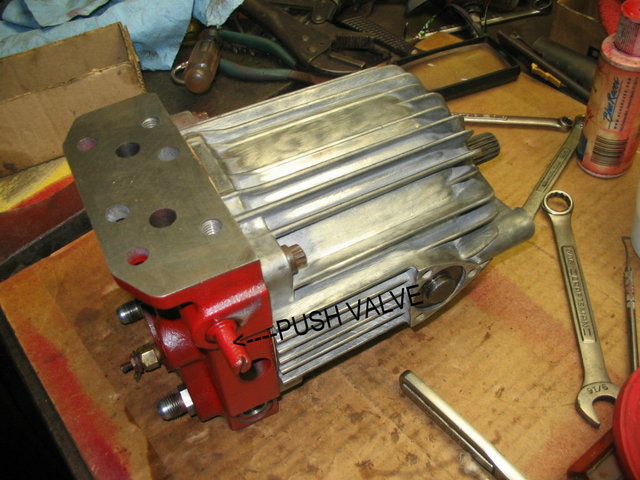

tinkerer 0 #3 Posted April 7, 2015 (edited) Dave thank you for responding. The push/tow valve screw is bound tight and cannot be adjusted yet. I'm soaking it with penetrating oil but still no action. Is closing this screw adjustment a prerequisite for priming the pump?? Edited April 7, 2015 by tinkerer Share this post Link to post Share on other sites
daveoman1966 3,884 #4 Posted April 7, 2015 The PUSH valve is not related to pump priming. You said the tractor could be pushed manually and that can only be done if the PUSH valve is in the OPEN position. If it is closed, and everything else is normal, the tractor would be VERY DIFFICULT to move manually. Whats more, it should NOT be moved with the push valve closed. If you have hyd lift, break loose a fitting somewhere and see if fluid seeps out. If it does, then that's a good sign. If not, then there are further issues to investigate. 1 Share this post Link to post Share on other sites
