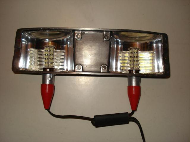

callum12 257 #1 Posted April 5, 2015 Hi all, A while back i started a thread asking about the suitability of LED headlights for my A-800. I was in full swing with wiring them then I had 3 months with no tractor while it was at a friends workshop to help me with the exhaust. so I finally got it back and have really kicked off again. the LEDs are wired in and are really bright. At first I was unsure about the bright white light rather than the more yellow light from a filament bulb, but after testing I think the modern brightness contrasts nicely with the rustic old-ness!! I shall upload some more detailed shots and night testing tomorrow but for now here you are: nice old style lamps made by a company called Ring, not sure of the brand reputation but seem just fine to me. the LEDs are from eBay and labelled as 'Cree' 7W 12V LEDs. that's 7W for the two! LEDs are amazing: please excuse my rather shifty look! the photo, it was taken by surprise and it looks like i'm hot-wiring the tractor to steal it or something! lol the dog is Willow. the LEDs look quite unimpressive here but they are actually very bright: I shall explain and photograph the wiring and earthing methods tomorrow when i can get some good pictures. i hope you have enjoyed looking, Callum 4 Share this post Link to post Share on other sites

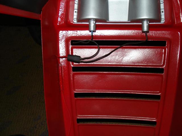

callum12 257 #10 Posted April 6, 2015 As promised, here are the more detailed shots of the wiring, the night time pictures will come later on sorry to keep you on the edge of your seat!! starting at the switch, this is a large toggle style switch with a 15A (can't quite remember) limit. I bent the lower tab to insure it wouldn't short on the dash. I then have a fuse in a fuse holder, I am using a 3A fuse for the LEDs, not sure where I'm going to mount the fuse holder just yet: the wire from the fuse then runs under the chassis (away from any movement) and pops out through a hole used to access the front axle greaser. the wire then goes into the bonnet where it splits via a piggy back spade connector to the two lights not sure how you can hold back the wires to look neater without drilling though the bonnet. any suggestions>> the lights are then earthed to the bonnet using their mounting bolts, I cleaned off the old paint and rust to insure a good connection. I used rubber grommets to avoid the metal rubbing through the wires the bonnet then has an earth strip running from the bolt that mounts the sheet metal to the hinge going to one of the engine mounts. this is to insure a good earth as the bonnet hinges are pretty loose at the best of times! might turn some nylon bushings using my lathe. and finally here is a shot of the dash board, looks totally original at some point i may add some dash lights that come on with the headlights (LEDs of course) so i hope you enjoyed plenty more pictures, stay tuned for the night time testing!! Callum 1 Share this post Link to post Share on other sites

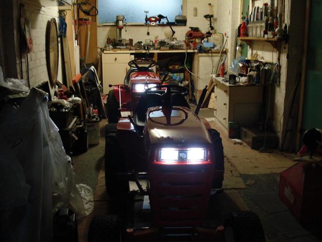

callum12 257 #11 Posted April 6, 2015 (edited) Finally some night time testing photos, the first picture is just to show how dark it was: and with the lights on: nice lens flare here, like and action film: success i'd say, Callum Edited April 6, 2015 by callum12 2 Share this post Link to post Share on other sites

meadowfield 3,191 #13 Posted April 6, 2015 Job well done I'd say! To tidy up the wires, maplin do stick on clips that you run a zip tie through. I use them on my hoods, much neater than tape or letting them flap about! Share this post Link to post Share on other sites

callum12 257 #15 Posted April 6, 2015 I need to go to maplin soon anyway, I'll definitely pick up some of those. the bulbs in mine are the H3 size, I reckon they will be a LED replacement for most sizes, If not I'm sure it wouldn't be too difficult to modify and make your own bulb holder. remember to change your fuse though! just a thought, these pictures where taken with the engine off, so not charging the battery. the voltage should be around 14V when charging so they might be even brighter!! Callum Share this post Link to post Share on other sites

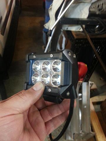

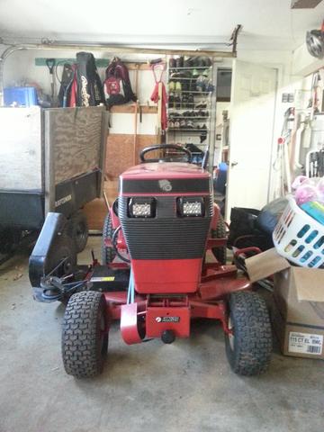

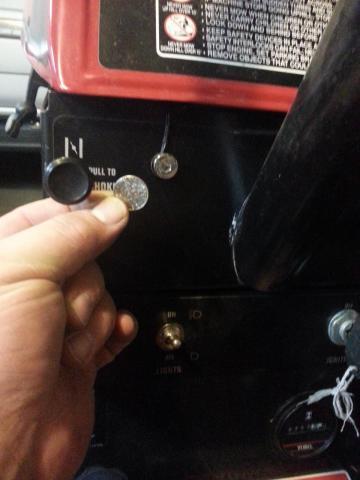

DotheDoo 15 #18 Posted April 7, 2015 (edited) I upgraded my lights too. Much better at night. Also added some small license plate lights to aim down on the shifter/dash area. They are smaller than a dime but they put out a lot of light. I have one on each side of the steering column. I fabricated a bracket to hold the new LED lights keeping the stock round head light plate in place. Edited April 7, 2015 by DotheDoo 1 Share this post Link to post Share on other sites
callum12 257 #19 Posted April 7, 2015 very nice indeed, I might do some dash lights too. did you do them so they come on with the headlights? Share this post Link to post Share on other sites

DotheDoo 15 #25 Posted May 22, 2015 PEP Boys by me is starting to stock a lot more LED bulbs now so it is a lot easier to get replacement bulbs. But, the complete LED light, Amazon is still the better location for lamp kits. Be sure you are getting them from a US distributor so they arrive quickly and not being shipped from Hong Kong or other places in China. Warranty can be managed a lot quicker. Also be aware of beam width. Most will list a 8 degree, 30 degree or even a 60 degree beam. The larger the number, ie. 60 degree beam, the better the light spread is on the lawn in front of you vs lighting up the neighbors with a 8 degree pencil beam that is useless on a tractor. Doesn't light up the lawn at all.I want to install a rear light on mine, but I want the size to be small, made of metal, and out of the way. I'll post a pick once I have found something that works. The dash lights I posted earlier are wired to the head lights so all come on at the same time. I may do another set to shine down on the mower deck since I tend to find myself always cutting my grass late at night. Work long hours and kids have baseball games to watch.... Share this post Link to post Share on other sites
