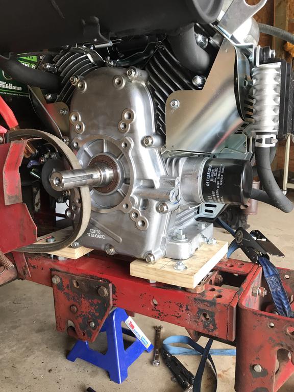

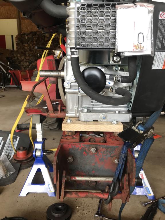

Jnmardister 1 #101 Posted May 9, 2018 So I’ve got the shaft taken care of. A buddy of mine is machining a sleeve and key. Mounting the motor on or on the other hand... I’ve got it mount with templates I made from wood and I can not for the life of me seem to get the tension on the belt correct. How did you manage to get proper tension? Share this post Link to post Share on other sites

Jnmardister 1 #104 Posted May 9, 2018 It’s a 312-8. I think I’m just going to make the mounts with slots to allow translation. Unless one of you has a side fire way to get it right where I need it. Share this post Link to post Share on other sites
