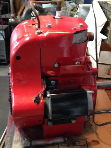

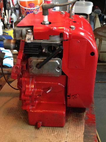

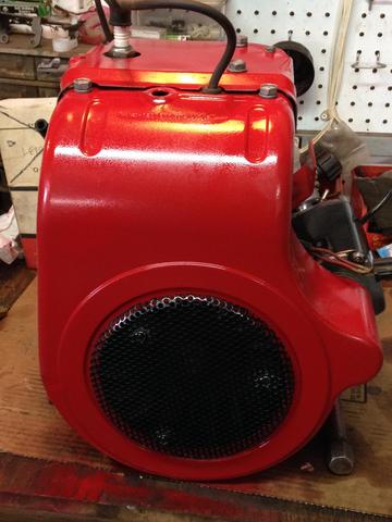

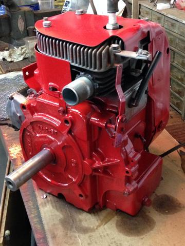

Dhodge 528 #4 Posted April 4, 2015 Nothing wrong with those Heavy iron Techy's. I have the ohv 16hp engine in my c-160. Its the same bottom end as you have with overhead valves and a larger carb. It runs well and seems very efficient. My brother is just now rebuilding a HH120 for his '66 Sears Suburban. Tecumseh used a smaller package than the big block Kohlers and were down a little on displacement across comparable HP ranges, but they seemed to be factory hot-rods. His Sears will go to town with a 48 in. deck. I think its stronger than My other brother's K321 in a Cub. I kinda like these motors myself. If only we could get more parts availability. It would be great to be able to get parts more easily and at a fair price. Just gotta put the carb and air cleaner on, make sure the CDI is gapped and touch up the paint a little bit. I forgot about the dings on the side of the flywheel tin or I would have bumped them out, but I already had the paint gun going. Pics are for you AMC!! 2 Share this post Link to post Share on other sites
