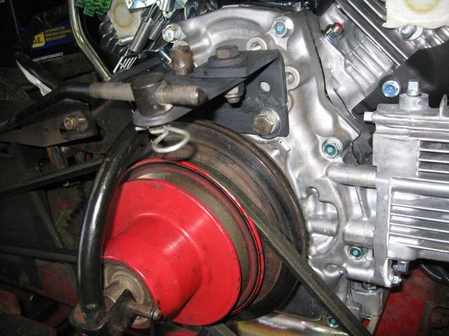

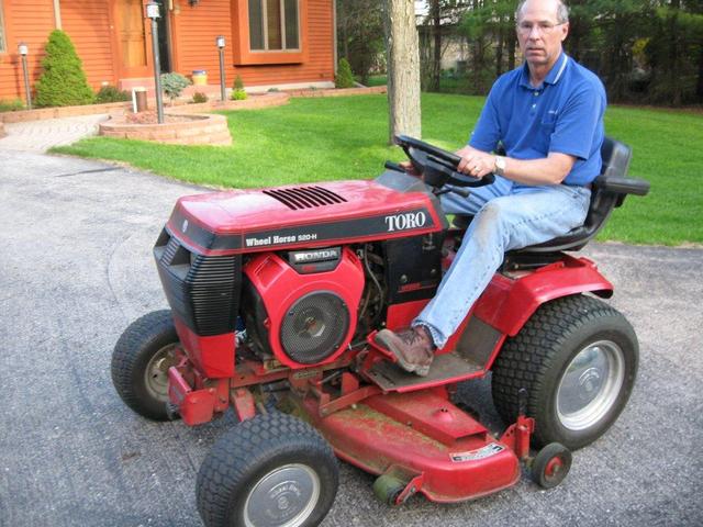

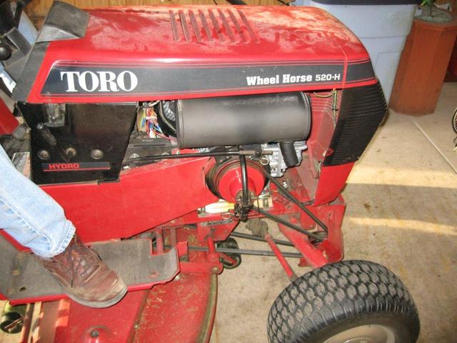

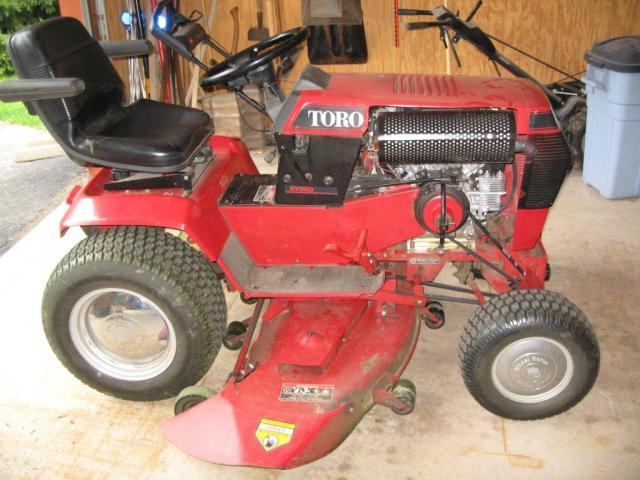

Red-Bovine 337 #18 Posted April 3, 2015 (edited) I repowered my 520H with a Honda GX630 kit from Repower Specialists. Their kit is pricey, but includes all the parts necessary to convert, including wiring. Everything works as original except the tachometer. I used a mini tach to check the governor speed and don't mind missing the tach. The only thing necessary to do is a small welding job for the clutch bracket on the engine. They include an adapter mounting plate and a sleeve for the clutch to convert from the Honda 1" shaft to 1-1/8". We have run the Honda for two years without a problem. It took less than two days to convert. I was not completely happy with the supplied muffler, not having a heat shield, so I replaced it with a Honda muffler. I needed to trim the hood a bit for the fit, but it works better and is quieter. http://www.repowerspecialists.com/ Red Edited April 3, 2015 by Red-Bovine 2 Share this post Link to post Share on other sites
