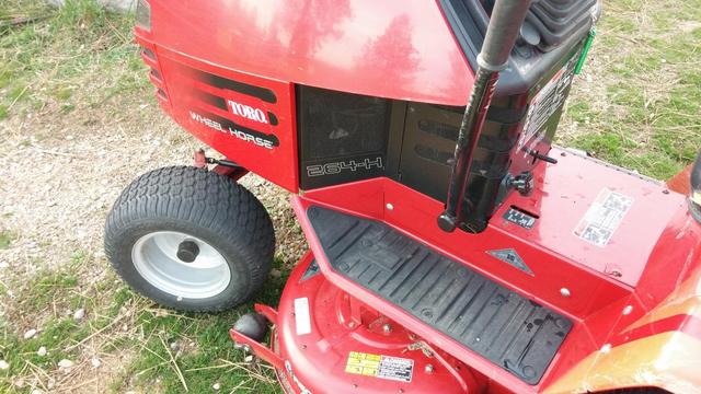

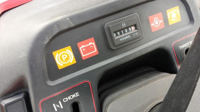

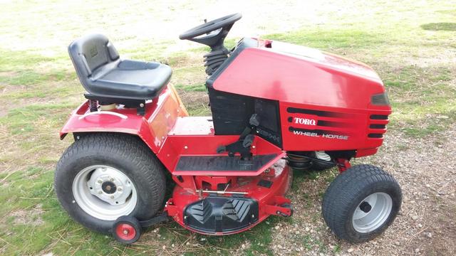

Apbrown 0 #1 Posted March 31, 2015 (edited) I bought this 1994 264H off craigslist. The seller had taken it in trade for some automotive work he had done for the original owner. Looks like the owner took good care of it and I will do the same. I have a question. I ran it around for about ten minutes after getting it home and the top of the transaxle between the rear wheels is smoking a little. The seller greased everything and changed all of the fluids prior to selling it so I assume he could have spilled some fluid on the case. Does the hydo-transmission on these get hot enough to smoke if there were fluid spilt on top of them? Also, there is a slight high pitch squeal while the PTO is engaged, I assume this is a belt that needs adjusting. Am I correct? Thanks in advance for your input. Andy Edited March 31, 2015 by Apbrown Share this post Link to post Share on other sites
