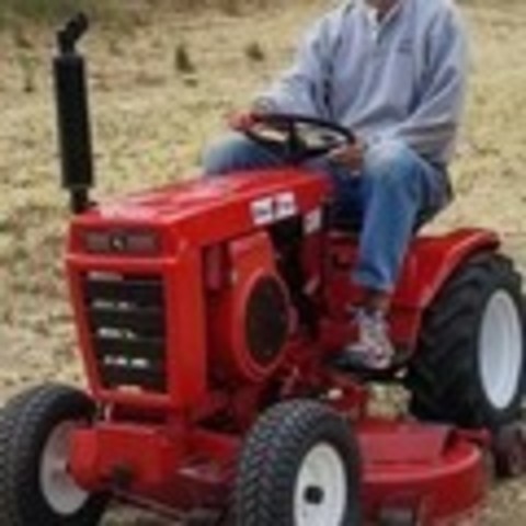

HorseHead1089 100 #1 Posted March 30, 2015 Is a 48in deck the biggest the c series can hold or is it able to hold any bigger decks? Looking to out it on a C-111 eight speed. A 60 in deck would be sweet but I know the 520 had a specail front axle for that deck Share this post Link to post Share on other sites
pfrederi 20,883 #2 Posted March 30, 2015 With out major modification 48" is it. Besides 11hp would be nowhere up to a 60" deck Share this post Link to post Share on other sites
Don1977 606 #3 Posted March 30, 2015 A 48" deck is a bit much for a C-111 better suited to a 42" or 36" deck. Share this post Link to post Share on other sites
HorseHead1089 100 #4 Posted March 30, 2015 Thanks for the input! Share this post Link to post Share on other sites
tunahead72 2,635 #5 Posted March 30, 2015 42" was the largest deck Wheel Horse provided from the factory for the C-111. Check this out: Share this post Link to post Share on other sites
Racinbob 13,046 #6 Posted March 30, 2015 (edited) I bought a GT-1100 brand new for a song with no attachments. I figured I'd slap a larger Kohler on it when the 11hp Briggs died. I had an extra 48" deck so I put it on. At the time I was mowing several acres a week and that Briggs surprised me. It even handled the deeper stuff with no problem and I didn't have to go to a lower gear. That Briggs was still going strong 16 years later when we moved down here. Edited March 30, 2015 by Racinbob Share this post Link to post Share on other sites

tarcoleo 120 #9 Posted April 3, 2015 Have a C-111 and a C-81 (identical chassies) with a Honda 11-hp and a Honda clone 13-hp, resp. There's more than enough power for the 48" decks on both -Tom Share this post Link to post Share on other sites
