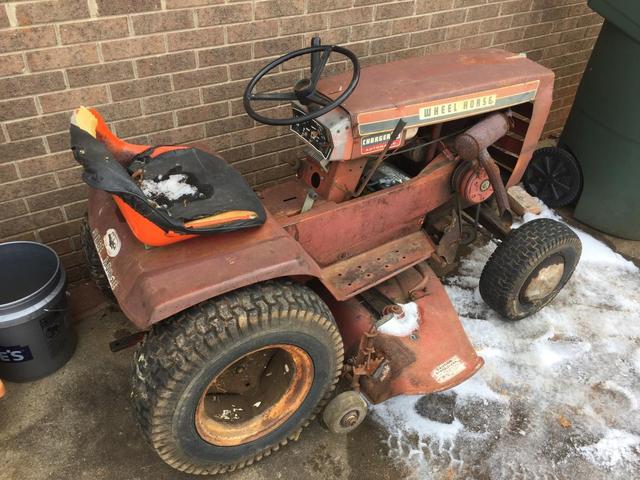

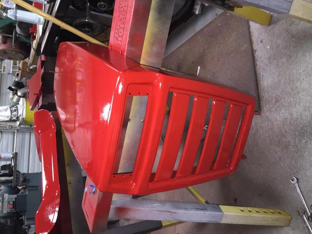

Mgryder1 16 #15 Posted March 30, 2015 This is my rust bucket that I literally saved from the scrap yard for $50...I've got it torn completly down, sandblasted, primed and painted. I need to sandblast the rims and put the new tires on so I can start putting her back together. The hood picture is all I have to represent how the restor is going. 1 Share this post Link to post Share on other sites
tbarnhart 240 #17 Posted March 30, 2015 Looking at your pic, I would certainly say you have the norrow rim. See how the original 6.50s squeeze down narrow at the bead. They look just the same as the old rotten tires I replaced on mine. Share this post Link to post Share on other sites

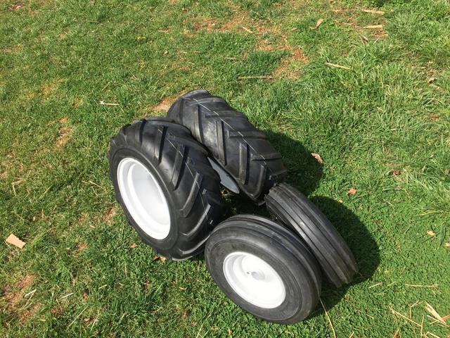

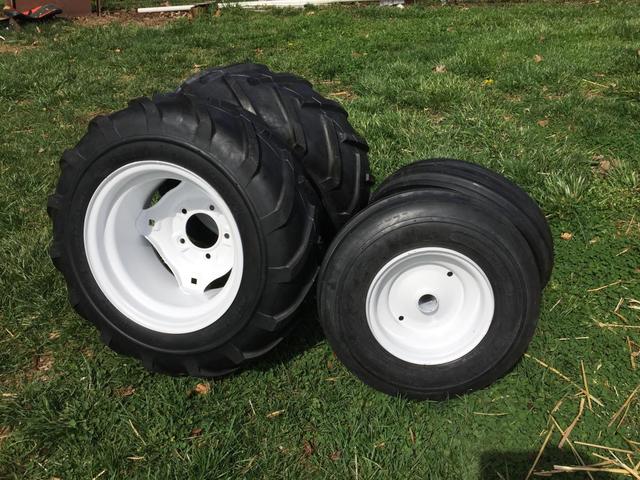

Mgryder1 16 #25 Posted April 4, 2015 (edited) Got the wheels restored and new tires mounted. I was going to replace the tires myself but discount tire removed the old tires, installed new valve stems, and installed the new tires for $40...it would have taken me forever to do it. Money well spent IMO. Edited April 4, 2015 by Mgryder1 Share this post Link to post Share on other sites
