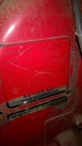

stratostar250 934 #1 Posted March 30, 2015 So, as a few of you may know, I recently bought a 1969 Charger 12. I brought it home, not running, but luckily, I connected a pair of jumper cables, and after a little bit of cranking, she started, and runs pretty well, on two or three year old gas. Now, maybe this belongs in the electrical section, but here it goes. After I disconnect the jumper cables, It will continue to run for only about 20-30 seconds. It seems to be more electrical related, because it acts as if the key switches off, I can't bring it back or even get a sputter by fooling with the choke or throttle. I am not very educated in the electrical systems of these tractors, but I am a good listener and normally understand well! If you guys have any ideas, please let me know! Even if you think it may be the old old gas getting to the carb for a second, or if it could even be the extremely dead battery (but i've ran tractors before with dead batteries and never had this problem). Thanks for your help! I appreciate it! Share this post Link to post Share on other sites

stratostar250 934 #4 Posted March 30, 2015 (edited) I think I should change the title of this thread I went out in the garage really quickly to check one thing, and I learned a lot more about my new tractor! I found out my Charger 12 has had a transplant at some point! I'm glad I looked! Charger 10, shall I say? Edited March 30, 2015 by stratostar250 Share this post Link to post Share on other sites

stratostar250 934 #7 Posted March 30, 2015 Thanks guys. I honestly figured trying to run with the old gas was problematic by itself. I'll drain it, and clean the carb. I have no problem doing that. Where is the best place to get fuel line? I have some filters I can use, so that's no problem. Oh, and Duane messaged me, he said the P.O. Changed the tins, its still a 12 hp, so that's good to know! Share this post Link to post Share on other sites
