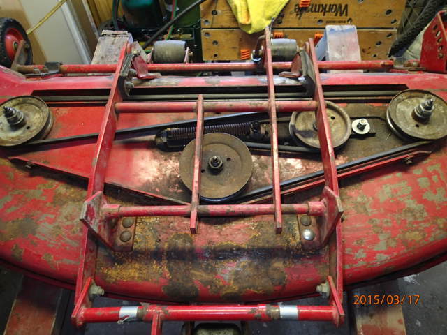

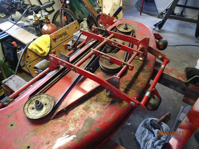

jjs 0 #1 Posted March 29, 2015 I know, fat chance, but can anyone venture a guess at the model number, need parts for it. 48 inch and the tractor is a c-161, a 42 inch deck came off it, this was one is a replacement. Any guesses, thanks joe Share this post Link to post Share on other sites
daveoman1966 3,883 #2 Posted March 29, 2015 (edited) It is definitely a 48" deck...likely to be 05-48MS05 (01 thru 05)or it may be a 78360. These decks are next to identical and are interchange4able from about 1973 thru the very last production year (2007 ? ? ?). The single main difference is the SPINDLE SHAFT and TOP PUKKEY(s). Earlier models have a woodruff keyway in the 3/4" shaft / pulley connection and the more recent models are without keyways, using a step-down shaft (to 5/8") with a pressure fit top pulley. Yours APPEARS to be the more recent style, but tuff to tell from the pics. I have lots of parts for this deck....whst do you need? send me an OFF-SITE email so I can post pics I am: daveoman@windstream.net Edited March 29, 2015 by daveoman1966 Share this post Link to post Share on other sites
