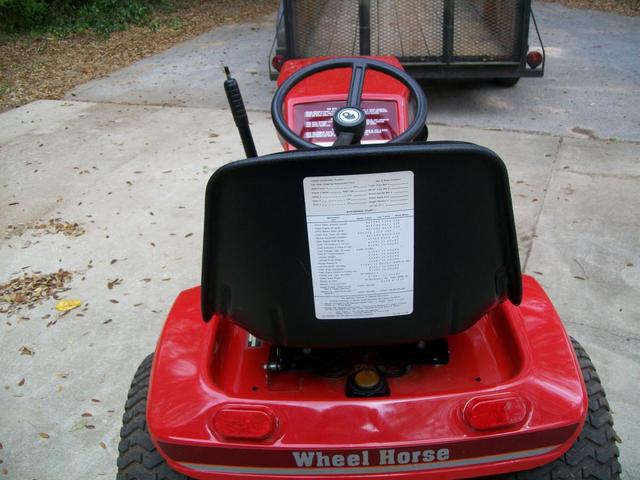

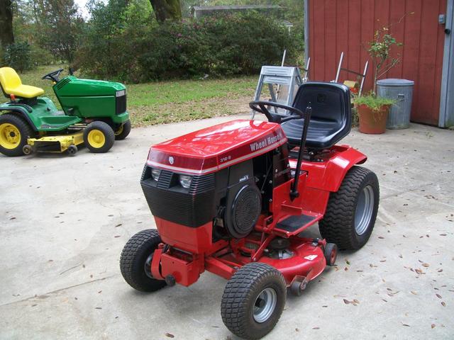

clueless 2,898 #1 Posted March 29, 2015 Bought this last year from a guy who bought it from his sister-in-law. 575 hours, always garaged, and dealer maintained. Never seen rain and never been wet. Maintenance information on back of seat. Still looks new. This one is as good as it gets in the South. Bought it as my back up lawn tractor and haven't used it. But I took it out today and noticed a knocking noise in every gear and it gets faster as the speed increases. Also, when I push it in neutral I can hear a slight knocking noise. I have only had hydros and 4 speeds. This is my first 8 speed that actually runs. Don't know if this knocking is normal or something I need to look into. PO had all fluids changed prior to me buying it. When I test drove it last year I only drove it with the deck running so I don't know if the noise was there. Any help would be appreciated. Thanks, Chris from Florida 1 Share this post Link to post Share on other sites
