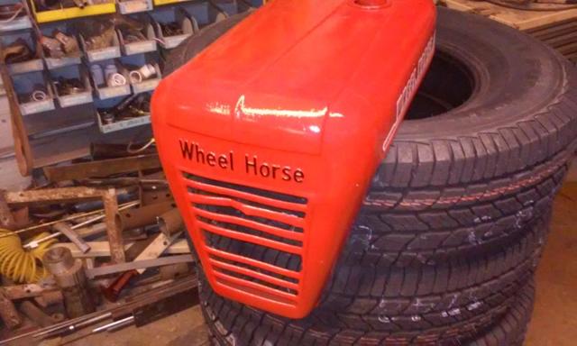

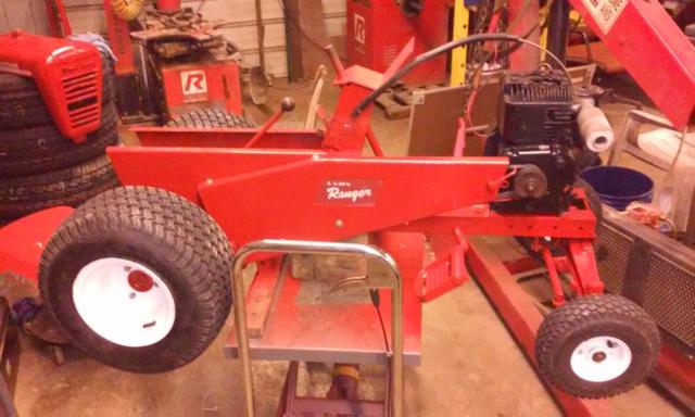

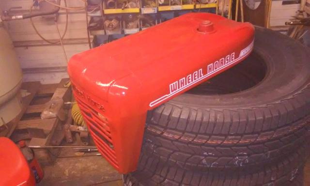

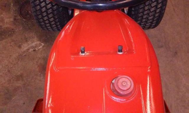

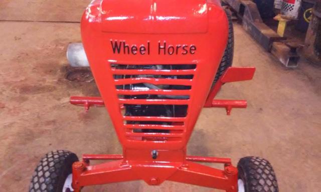

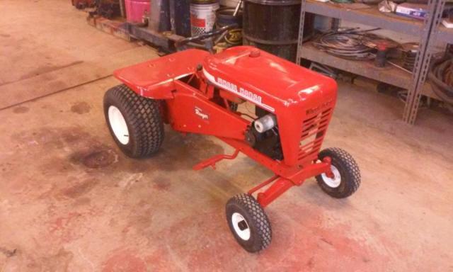

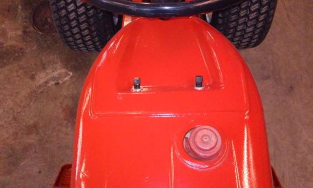

steve k 82 #1 Posted March 26, 2015 Here are some pictures of my quickie lawn ranger clean up. I wire brushed the hood and fenders then painted, bead blasted the wheels then painted and install new tubes and rubber. Took the 5hp briggs off cleaned with carb cleaner and painted. Pressure washed the rest really good and painted. Made my own thumb screws for the hood with the lathe. Put on some decals I had left from another project(I know they're incorrect). I also removed the lift arm. Kind of a use what I had low buck build up! The engine is crazy reliable and starts easy so I did not tear into it and the transmission is flawless with no leaks so that was left alone. It will be used at antique engine shows I attend to pull a sulky around. Being short it fits in my truck with the cap on and is easy to load/unload. Share this post Link to post Share on other sites
Terry M-(Moderator) 2,329 #2 Posted March 26, 2015 Looks like you may have mounted a gas tank to the underneath of the hood?? If thats right...may I see how you did it?? The rest looks good for a quick spruce-up Share this post Link to post Share on other sites
steve k 82 #3 Posted March 26, 2015 You're right Terry, it was like that when I got it. It is just a plastic tank with two straps around it and riveted to the hood,holding it up against the hood. The briggs didn't have a tank bracket and someone switched the suction carb to a float style to make room under the hood. The hood is a bit of a pain to remove now though as the fuel line needs to be unhooked(thinking about getting a quick disconnect off ebay) If I have it off I will snap some pics. Share this post Link to post Share on other sites
Terry M-(Moderator) 2,329 #4 Posted March 26, 2015 Ok, thanks....always curious of how to do some modifications on my Lawn Rangers. engine change = gas tank modification on these tractors Share this post Link to post Share on other sites
Sparky-(Admin) 26,623 #5 Posted March 26, 2015 Thats a perfect machine for riding around a show! Mike........ 2 Share this post Link to post Share on other sites
steve k 82 #6 Posted March 27, 2015 you are exactly right Sparky! Share this post Link to post Share on other sites
RedRanger 1,470 #7 Posted April 1, 2015 That style decal looks 10 X better than the original decals. 1 Share this post Link to post Share on other sites
Pullstart 71,483 #8 Posted April 1, 2015 I like the black on red raised letters! nice work, how much time would you say you have into the clean up? Share this post Link to post Share on other sites
steve k 82 #9 Posted April 3, 2015 The black on the raised letters is just a good sharpie marker! Was very easy took about ten minutes?? overall probably took 2-3 weekends. Share this post Link to post Share on other sites
