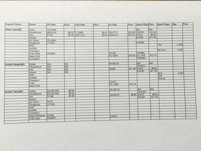

wh5208speed 677 #4 Posted March 26, 2015 (edited) Wheel Horse Hydro Filter Cross-Reference Wix 51410 Napa 1410 Amsoil EAO40 Fleetguard HF6096 Fram PH2844 Donaldson P550940 Toro/Wheel Horse 79-5270 If someone can tell me how to upload an excel file I will put up my whole list of cross-references that include oil, air, fuel, hydro and spark plugs. Napa is having a sale right now on their Napa Platinum's which have synthetic media and are exactly like the Wix XP line. They are normally $12.99 and I got mine for $7.99. Thad (Ohio) Edited March 26, 2015 by wh5208speed Share this post Link to post Share on other sites
wh5208speed 677 #5 Posted March 26, 2015 (edited) Figured out two different ways. 1. Print off....take a photo, turn into a PDF and then upload 2. Print off....take a photo, send as a JPEG and then upload. If someone does want the excel sheet so they can add more models I will be more than welcome to email it to them, or if someone can tell me how to upload it to the group I will. The Tractors I used are Onan Twin/WH - 520's, 416's etc Kohler Twin/WH - 417, 418, 420 with KT or Magnums Kohler Single/WH-C-161 with K-341 that has the thicker air filter with the smaller diameter. Thad (Ohio) Wh filters - Mar 25, 2015, 9-32 PM.pdf Edited March 26, 2015 by wh5208speed Share this post Link to post Share on other sites
