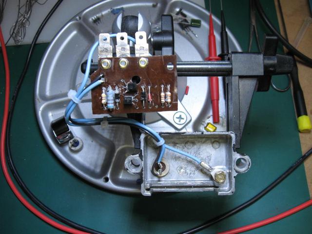

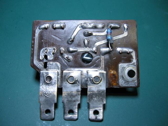

Save Old Iron 1,563 #11 Posted March 22, 2015 (edited) The over whelming majority of regulators I have investigated have died from poor solder joints from the manufacturer - ultimately opened up by vibration on the tractor - or from corrosion of the copper traces and terminals attached to the circuit boards. The RR below shows many poor solder joints. The failure of this RR was due to the resistor (blue banded object in photo) pulling right out of the solder joint. This resistor is the "calibration" of the RR unit to regulate at 13.8 volts. Without this reference, the RR could not function. Simply re-soldering the connection brought this RR back to life. P.S. also note in the image below, the two wire terminal tabs are soldered and riveted together, therefore are electrically the same connection. This image further confirms the myth if these two terminals show a short, the RR is bad, Measuring two terminals shorted is not a confirmation the RR is bad. Edited March 22, 2015 by Save Old Iron Share this post Link to post Share on other sites

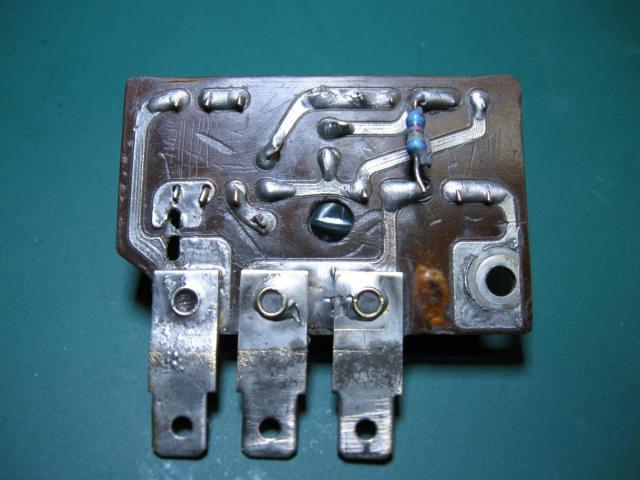

Save Old Iron 1,563 #12 Posted March 22, 2015 another RR view Share this post Link to post Share on other sites
Save Old Iron 1,563 #13 Posted March 22, 2015 (edited) another bit of food for thought - if there was a possibility of the RR destroying itself without a load attached, you would think we would see a dead RR with every instance of corroded wiring to the ignition switch, disconnecting the RR from the 12 volt battery. I am open to discussion on this but I cannot see any electrical property of the RR that would allow itself to "burn out" without a load attached. The sticker stating do not run without a battery attached is on several models of tractors. I 'm wondering if the sticker appeared when indicator boards appeared on later models. Edited March 22, 2015 by Save Old Iron Share this post Link to post Share on other sites
