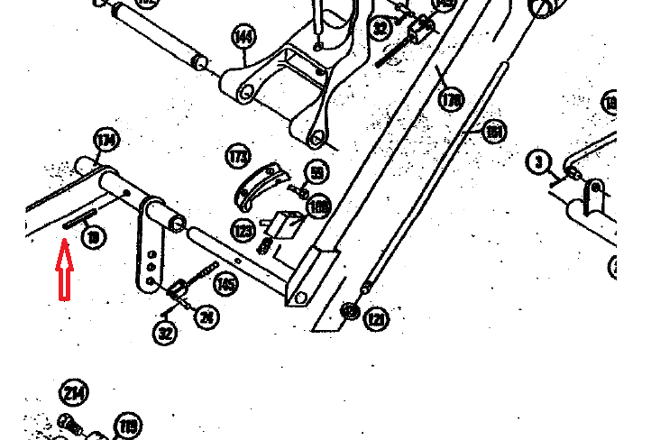

rmaynard 17,422 #2 Posted March 18, 2015 (edited) Lift lever does not engage with what? Can you elaborate? Can you post some pictures of how you have the lift connected to the plow? If your lift lever is moving back, and the plow isn't lifting, you probably have a sheared roll pin in the lift. Edited March 18, 2015 by rmaynard 1 Share this post Link to post Share on other sites
