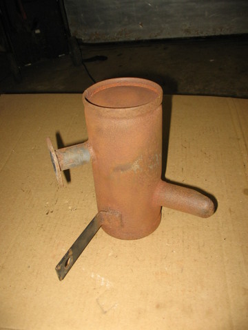

daveoman1966 3,882 #2 Posted March 18, 2015 DOES YOUR MUFFLER LOOK LIKE THIS ONE? If so, send me an OFF-SITE email for mor info. my direct email address is: daveoman@windstream.net As for the hood hinge, I probably have a replacement for that too. Share this post Link to post Share on other sites
