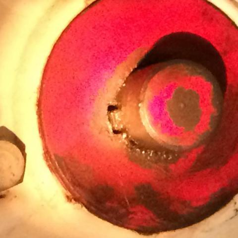

Al C. 1,480 #8 Posted March 26, 2015 How tightly should the wheel hub fit to the woodruff key? Before I tighten the set screw I have about an inch of play at the outer circumference of the tire. When I tighten the set screw this goes away. I have not had any problems with this but I'm wondering if one is brewing. Share this post Link to post Share on other sites
stevasaurus 23,861 #9 Posted March 26, 2015 Al, it should slip on rather easily, but the key should not have any slop on the sides. In other words, the hub should slide off the axle with no problem (before tightening), but the key should be a good fit in the axle and in the hub key ways. Side to side is what is important here. Share this post Link to post Share on other sites
Al C. 1,480 #10 Posted March 26, 2015 I appreciate you getting back to me so quickly. Well then, I guess I have a problem brewing (I've attached a picture). I'm going to keep the set screw very tight and cross my fingers. As I said, I haven't experience any performance problems yet. Maybe I'll be lucky. Thanks! Share this post Link to post Share on other sites
Al C. 1,480 #11 Posted March 26, 2015 The picture ... 1 Share this post Link to post Share on other sites
stevasaurus 23,861 #12 Posted March 26, 2015 Yep, that key way is wallowed out a little. Options, get another hub from somebody here (want ads)...get that one welded up and re-cut...get that one cut 90 degrees from where it is at. Hope that helps. Pictures are worth a thousand words. Share this post Link to post Share on other sites
Al C. 1,480 #13 Posted March 29, 2015 Thanks for the ideas. I like the two options of reusing the existing hub. Unfortunately, I don't have the tools to perform either of these operations. So, I found two new hubs on eBay yesterday. Pictures look like new. Should arrive next week. I appreciate your help. 1 Share this post Link to post Share on other sites
