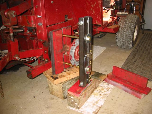

tractorhogg 656 #8 Posted March 13, 2015 D hubs can be a real problem. Do not pull to hard on the hub flange it is much thinner in relation to the length of the hub than other horses and it will break. Pull against the back of the hub. I would not recommend RTV if you do choose to use it be exceeding careful that no excess squeezes out inside the system. It only takes a tiny bit coming loose to cause a problem...have you ever looked at the size of the hole in a Sundstrand acceleration valve? Thanks for the input, my friend and I had a machinist build a custom hub puller similar to the one in the picture, but the previous owner had already pulled this one, so the hub is off. I do not care for RTV, because unlike using a gasket, I continually think of where the RTV might be, or might not be Share this post Link to post Share on other sites
