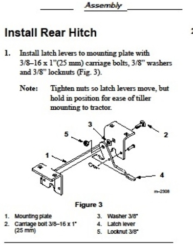

groundhog47 448 #4 Posted March 9, 2015 (edited) Ok, the mid has two options so ta speak. The mid attach-a-matic (think prop name) is where they attacn until get to the wider balde (50 +) which rear attaches. Do you have the one that has side lever to change angle or "T" handle above sector? That'll put us better at finding yours. side handle sector lock model "T" handle sector adjust model pushed example which does use a different rear axle attach (prob a D)(yes and 18 auto) Attached pic of part (bottom ) of axle hitch Edited March 9, 2015 by groundhog47 Share this post Link to post Share on other sites

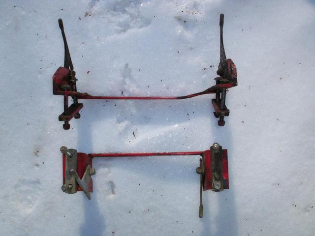

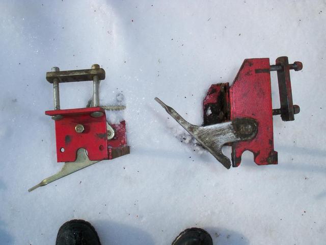

Kelly 1,038 #14 Posted March 11, 2015 Old style bracket mounts in front of the axle, like a GT14 would, new style mounts under the axle, makes about a 2" difference, old style is wider also. old style on right Old style on top (the cross bar is bent) new style on bottom 1 Share this post Link to post Share on other sites
