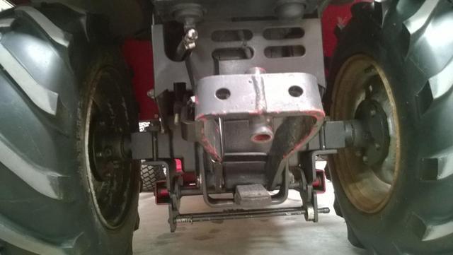

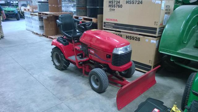

shallowwatersailor 3,221 #6 Posted March 7, 2015 (edited) Here is a thread with the 5xi plow discussion. Pictures of the rear Attach-A-Matic and plow. Edited March 7, 2015 by shallowwatersailor Share this post Link to post Share on other sites
