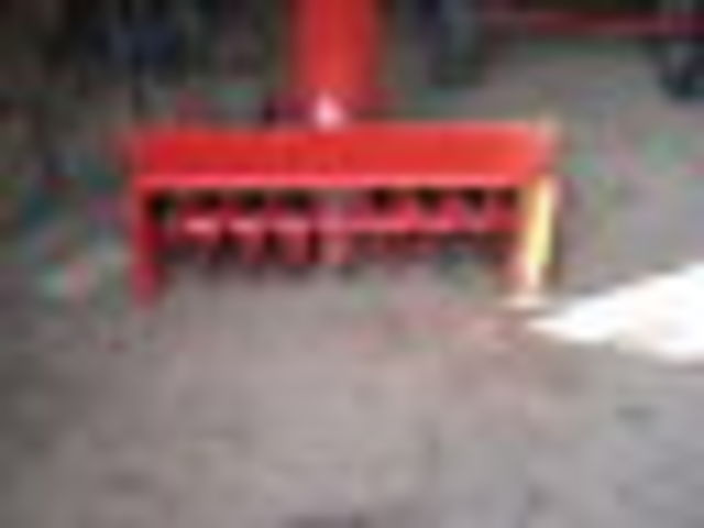

lodestonefarm 41 #1 Posted March 5, 2015 Will a older single-stage snow thrower (like the one below) fit and work on a 520? How does one know for sure? Thanks, Share this post Link to post Share on other sites
Rob R 989 #2 Posted March 5, 2015 I mounted the same blower on my GT 14 by adapting a Tach-a-Matic hitch to the front of the frame, You just need to calculate the belt you need when you get though mounting the blower (in my case 86-87 inch belt). I have been using this all this season with no issues... I mounted the same blower on my GT 14 by adapting a Tach-a-Matic hitch to the front of the frame, You just need to calculate the belt you need when you get though mounting the blower (in my case 86-87 inch belt). I have been using this all this season with no issues... I mounted the same blower on my GT 14 by adapting a Tach-a-Matic hitch to the front of the frame, You just need to calculate the belt you need when you get though mounting the blower (in my case 86-87 inch belt). I have been using this all this season with no issues... Share this post Link to post Share on other sites
Ed Kennell 46,175 #3 Posted March 5, 2015 I had one on my 520 before I got the tall chute. It worked fine. Just need the correct belt length and lift/push rod length. Share this post Link to post Share on other sites
lodestonefarm 41 #4 Posted March 5, 2015 Sounds like this is possible. Thanks for the responses. Peter Share this post Link to post Share on other sites
