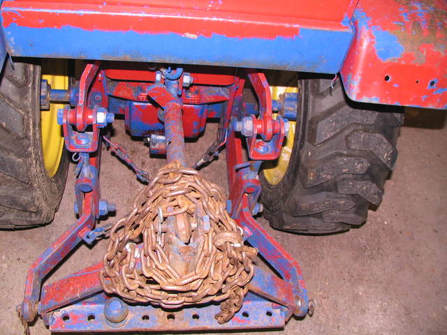

alswagg 128 #4 Posted March 4, 2015 I logged alot with my D last summer. Many were oaks 12" to 18" dia. I precut the trunks to around 12' long. This made it easier to pull than the whole tree. I have weighted ags in the rear and used a 3 point hitch. A short chain helps I found out the log pull great about 4' behind the tractor. Good luck Al Share this post Link to post Share on other sites

pacer 3,180 #6 Posted March 4, 2015 This is practically a permanent fixture on my D ... that smallish tractor constantly amazes me at what it will do As Al says, you'll probably have to experiment a bit with sizes/length that you can pull, but I bet your gonna be surprised at what you can accomplish! Share this post Link to post Share on other sites
