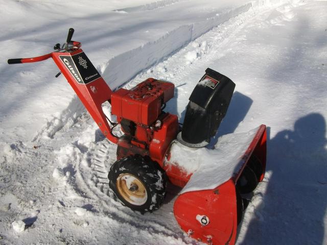

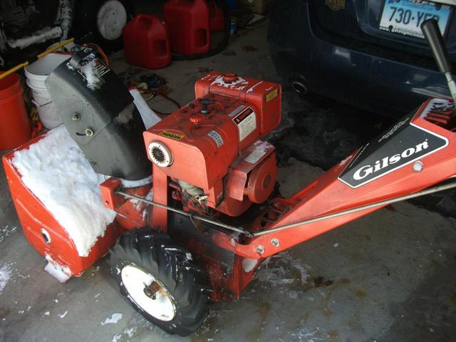

Sparky-(Admin) 25,964 #12 Posted March 3, 2015 My old Gilson snowblower does the same thing... Also an 8 HP B&S..... Mine was bought new in May 1974, and it still runs strong today! Interesting! This is my Gilson snowblower that's throwing the flame, its a 1978. Mike.......... 1 Share this post Link to post Share on other sites
Navig8r 132 #13 Posted March 3, 2015 Interesting! This is my Gilson snowblower that's throwing the flame, its a 1978. Mike.......... Mine's a Montgomery Ward machine made by Gilson that my grandfather bought new in May, 1974.. i have all the original documentation, including the sales slip... great machine... They were well made, and well designed! Are you familiar with ? Lots of good info there! 1 Share this post Link to post Share on other sites
Sparky-(Admin) 25,964 #14 Posted March 3, 2015 Are you familiar with ? Lots of good info there! Did you mean this site.. http://www.gilsonsnowblowers.com/ ...if so then yep, I've read it all. This is my flame throwing beast. Mike........... 1 Share this post Link to post Share on other sites
