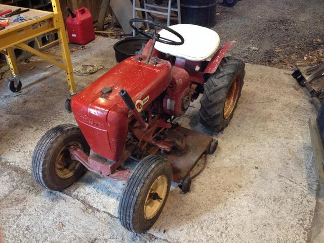

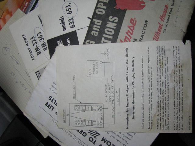

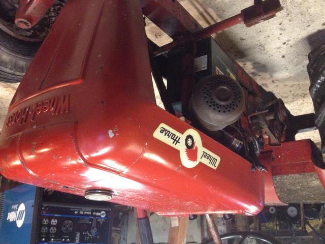

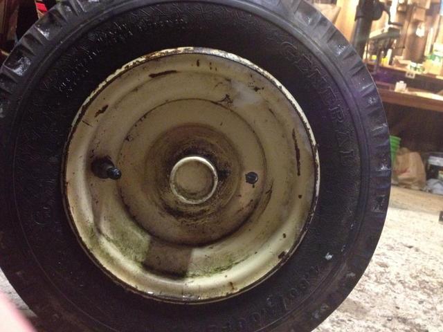

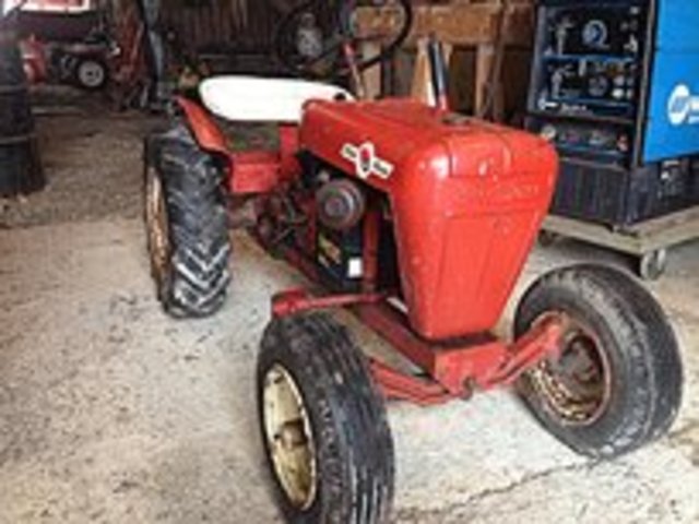

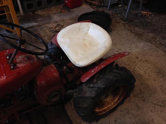

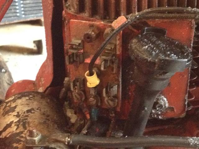

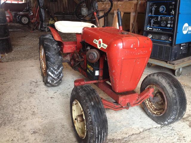

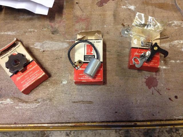

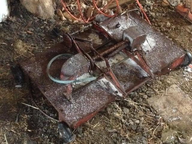

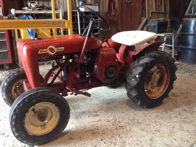

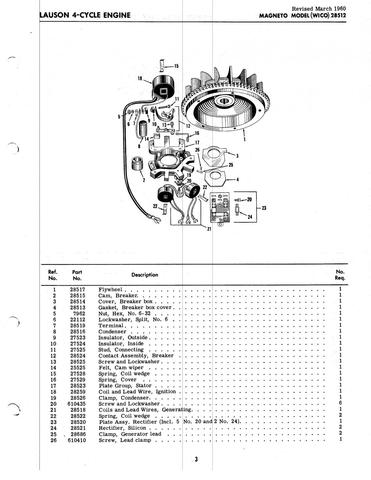

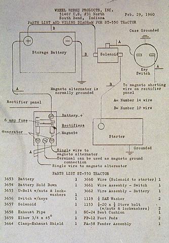

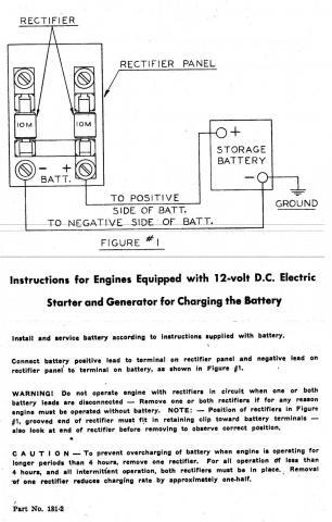

Old Ways 30 #1 Posted March 2, 2015 (edited) Well, a new Horse arrived in the stable today. 1961 551, and in really straight condition. I believe it to be an early restoration. I need to collect some parts, namely the fuse-box cover, belt guard, and muffler shield. It came with a straight mowing deck, and what I was told is an original seat cover. First, some pics: Mowing deck's tight, but I hope it will loosen up with fresh grease in the spring time. Now, first thing is first... to get the electrical system buttoned up: The tractor came with these parts: I know where the points and condenser go... but not the ignition brake? And can someone tell me what type of fuses I need? Next, why do the front rims only have one hole in them? I'd like to mount front wheel weights if/when I can find them... I assume I'll have to drill the other two holes. One the way here, is seems the trans froze up. I'm guessing water in it. Once it gets above freezing I'm going to drain the fluid. If the trans doesn't look good, I may replace it with an 8-speed. And I spent a little time cleaning up the hood once the ice melted off of it from the trip here... (Not too sure why this one uploaded upside-down, but okay...) Well, goodbye GT-14 and welcome 551! Now to find a brother for it... Thanks! Edited March 2, 2015 by Dane in PA 4 Share this post Link to post Share on other sites

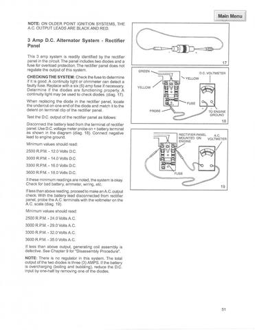

oldredrider 2,553 #2 Posted March 2, 2015 You don't need fuses. They are diodes that go in the holders. And yes, they are directional. Share this post Link to post Share on other sites
Old Ways 30 #3 Posted March 2, 2015 You don't need fuses. They are diodes that go in the holders. And yes, they are directional. Okay... Looks like I need to pick up some of these diodes. Share this post Link to post Share on other sites

AMC RULES 37,256 #6 Posted March 2, 2015 (edited) You have slots there for two diodes(rectifiers)... and one AGC-6 fuse...once it thaws, do a diesel flush, and fluids change. I doubt you'll find anthing wrong with that trans, was working fine in the "WH great" room. Congrats, nice new score there. Edited March 2, 2015 by AMC RULES 1 Share this post Link to post Share on other sites
Jake Kuhn 1,599 #7 Posted March 2, 2015 Looks like a very nice horse Dane! And as far as your question on the rims go, in 61 and 62 the front rims only had the one hole in them, I think you can probably mount weights with one hole, but I don't think back then they worried about weights as they filled the rims with fluid. Share this post Link to post Share on other sites

formariz 12,359 #9 Posted March 2, 2015 Nice tractor. One of my favorites. Get familiar with that rectifier I have additional literature if you need it. If you have trouble finding diodes send me a PM. I'll send you a couple for free. Have lots of them. Share this post Link to post Share on other sites

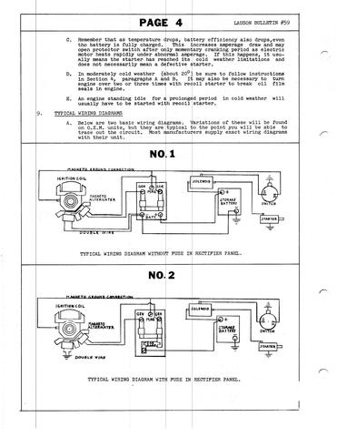

formariz 12,359 #11 Posted March 2, 2015 (edited) Someone here in vendor section makes that fuse cover. Here is some information to help you with electrical system. I will send you hard copies with diodes. Edited March 2, 2015 by formariz Share this post Link to post Share on other sites

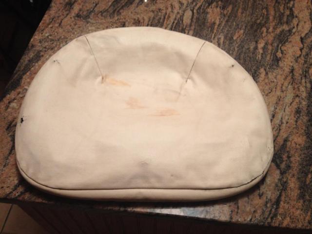

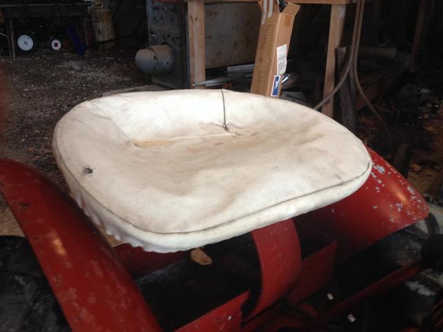

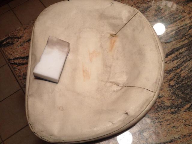

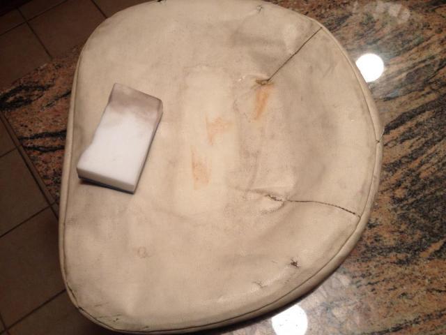

Old Ways 30 #14 Posted March 3, 2015 Not much to update on, but the seat over is already looking better! Before: During: After: Share this post Link to post Share on other sites
squonk 46,157 #15 Posted March 3, 2015 Those eraser pads work wonders! Share this post Link to post Share on other sites

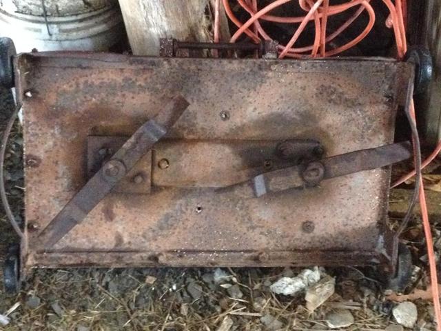

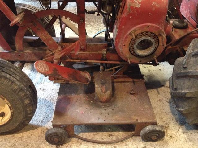

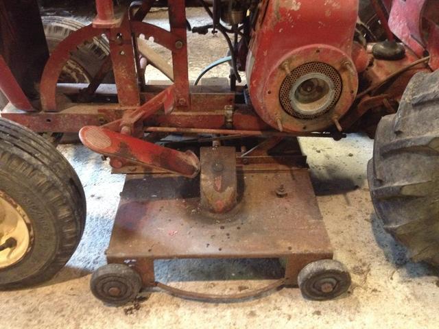

Old Ways 30 #20 Posted March 3, 2015 (edited) I wish these tractors were more plentiful in my area. Hahaha. Did a little more cleaning on the seat, and just loosely mounted the deck to see how it fit --out of curiosity. Looks really good, and especially when some of the oil gets into whats left of the paint --giving it back it's shine. (This whole tractor is going to need a good pressure-washing and gone over with a wire brush to get the paint flakes and gunk off --and possibly rewired) The seat cover came out really well. Just couldn't get the rust stains out --and some of the discoloration off of the lip that goes around the metal seat-pan. Next is the deck... after inspection, it's really tight --might be shot, but I'll clean it up in the spring and see what I can do. Some rust holes, but what can be expected of a machine of this age? Now, the first dilemma is... how are the foot rests supposed to be positioned as to allow the gearboxes to clear? Otherwise I get 1/2" of lift... Down Up Edited March 4, 2015 by Dane in PA Share this post Link to post Share on other sites
