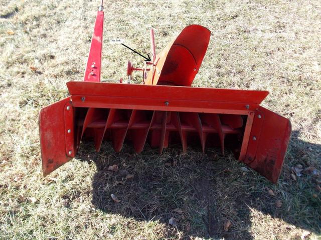

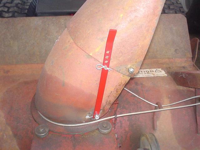

cleat 9,380 #1 Posted March 1, 2015 (edited) Hi; I have an older model short chute single stage snowblower and the upper chute deflector retainer link is broken off. Could someone measure yours and let me know the dimensions from the lower mount hole to the upper holes where it would slip onto the pin on the deflector itself ? Number of upper holes ? Space between holes ? This picture is not of my blower but just one I found to show the required link. Thanks, Cleat Edited March 1, 2015 by cleat Share this post Link to post Share on other sites

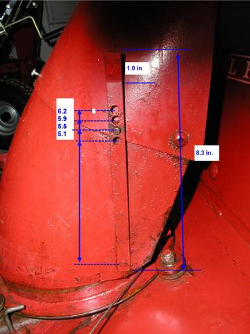

P3x 60 #2 Posted March 1, 2015 Hi Cleat, Took a pic of my ST Chute Deflector and added dimensions. Hope it helps: Good Luck! Share this post Link to post Share on other sites
cleat 9,380 #3 Posted March 1, 2015 Great; Thank you very much. Cleat Share this post Link to post Share on other sites

cleat 9,380 #5 Posted March 17, 2015 I have made and installed the holder. Thanks again for the info. Cleat Share this post Link to post Share on other sites
