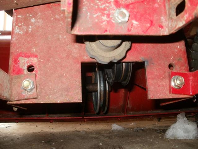

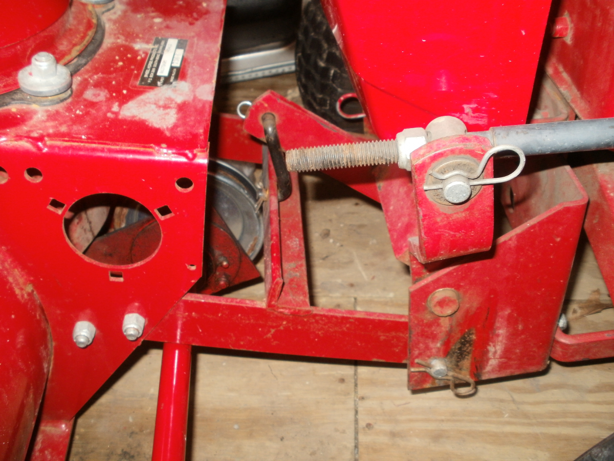

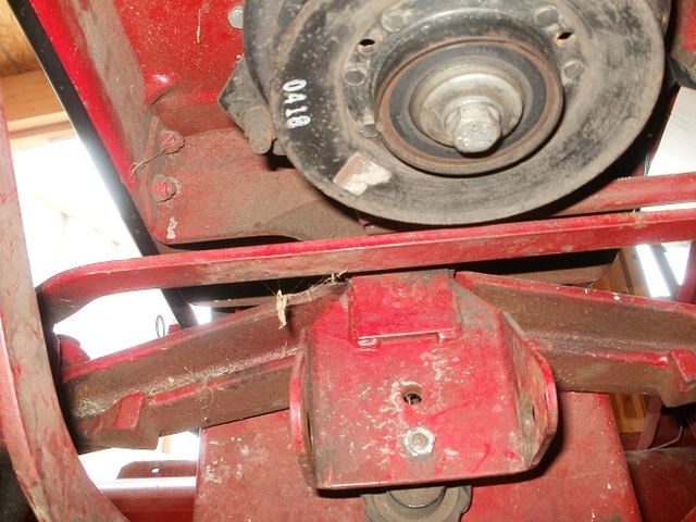

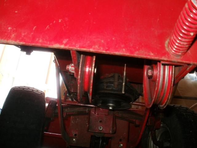

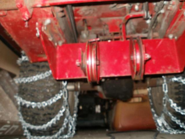

Charlie707 0 #1 Posted February 28, 2015 (edited) Have a 06-37SK01 Snow Thrower that has worked flawlessly for years. Threw the belt four weeks ago and bought a Gates replacement; but darn if I can figure out the installation of it! appears no manuals were published for this model of snow thrower as all I have been able to find is parts diagrams which show the belt only. Is the a better diagram available for it's installation? Thanks Edited March 1, 2015 by Charlie707 Share this post Link to post Share on other sites
Ed Kennell 47,034 #2 Posted February 28, 2015 Got any pictures of the belt area?? Share this post Link to post Share on other sites
gwest_ca-(File Mod) 12,463 #3 Posted February 28, 2015 We do not have the manuals for 1988 or 1989. Just discovered there was also a 06-37SK02 and the idler setup looks different. The operator manuals are listed in the parts lists. If I have it figured correctly put the belt on the engine pulley, goes back around the two idlers and then to the snowthrower pulley. Sitting on the tractor for left and right the belt goes from the left rear idler to the bottom of the snowthrower pulley. That way it should rotate the auger in the correct direction. Garry 1 Share this post Link to post Share on other sites
