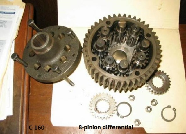

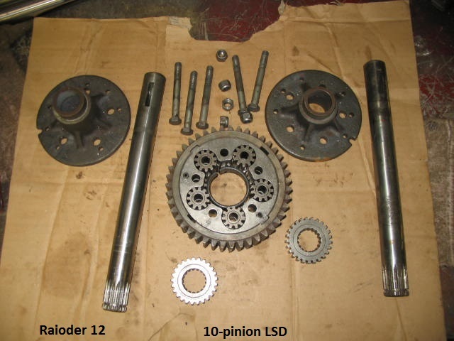

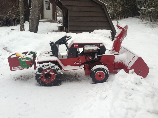

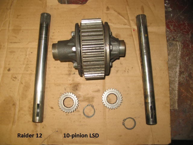

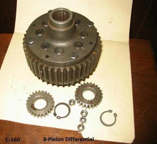

daveoman1966 3,884 #1 Posted February 27, 2015 (edited) I have (and love) a 1977 C-160 Auto with 10.5 wide shoes, 2-link chains, 75lb weights (2), and my 200lb bone bag, but still spin a lot on ice. Just one wheel spins and I know that is due to the 8-pinion differential. I have a complete 10-pinion LSD from a Raider 12 in mint condition and I want to swap that...in its entirety, into the C-160 gearbox. I know that will go a long way in reducing the ice-spin, but will it make an exact fit replacement of the original 8-pinion differential ? ? ? Here are pics of the 10- and 8-pinion differentials.... axles are both 1 1/8" dia. direct replies to: daveoman@windstream.net Edited February 28, 2015 by daveoman1966 2 Share this post Link to post Share on other sites
sorekiwi 761 #2 Posted February 27, 2015 I went the other way on one of my tractors, from a 10 pinion to an 8 pinion. I need to think a bit about it, but I am thinking that I had to swap an axle too, I am thinking the 10 pinion used different lengths?? The problem with the 10 pinion diffs now ( 50 years after they were produced!!) is that the spring clip thingy in the middle wears out, and it is NLA from Toro. That severely reduces the locking ability of the diff. The one in my 1267 still locks up, but the other two that I have owned have lost their traction ability. My belief is the best traction is the spider gear diff, but it is also the weakest of the Wheel Horse differentials, and I have blown up all the ones I have had. 1 Share this post Link to post Share on other sites
racinfool40 203 #3 Posted February 27, 2015 As Mike (sorekiwi) said if you do the swap make sure you get the axles in the right side of the 10 pinion differential as they are different length's...you can see the offset in the 10-pinios differential end caps...and make sure you use the corresponding axle gears as the axle gears a different between the 2 differentials also...Easy swap just make sure you have everything in the right spots before final assembly...hate to see a short axle in the wrong side...3" sticking out one side and 1" on the other...Been there done it... 2 Share this post Link to post Share on other sites
daveoman1966 3,884 #4 Posted February 27, 2015 As in my original post, I will swap out the ENTIRE differential, meaning to include both axles, (although not shown in my pics). Share this post Link to post Share on other sites

stevasaurus 23,795 #6 Posted February 27, 2015 I think I remember a thread on this subject, only in reverse...swapping out the 10 pinion for the 8 pinion. It had to do with how the ring gear meshed with the 11/44 toothed gear. Seams like I remember having to file or grind off a little of the 11 tooth part for it to fit. Since you are going the other way around, you may not have to do that. At any rate, you should be able to see if there is a problem before you bolt it up. The right hand axle is longer then the left. 1 Share this post Link to post Share on other sites
Forest Road 595 #7 Posted February 27, 2015 Believe it or not..... you need more weight! My "bone bag" comes in @ 270lbs. Add on cast iron wheel weights to boot. With that being said I also run 4-44lb suitcase weights and 5 gal gas. All kept in a box/rack hanging off a Scotty hitch. It's made a world of difference! 2 Share this post Link to post Share on other sites
