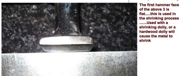

Road-Track 39 #35 Posted March 6, 2015 If it warps from too much heat, you have to shrink the metal to un-warp it. Use a planishing hammer with a wooden block for a backer. This will shrink the metal. 1 Share this post Link to post Share on other sites

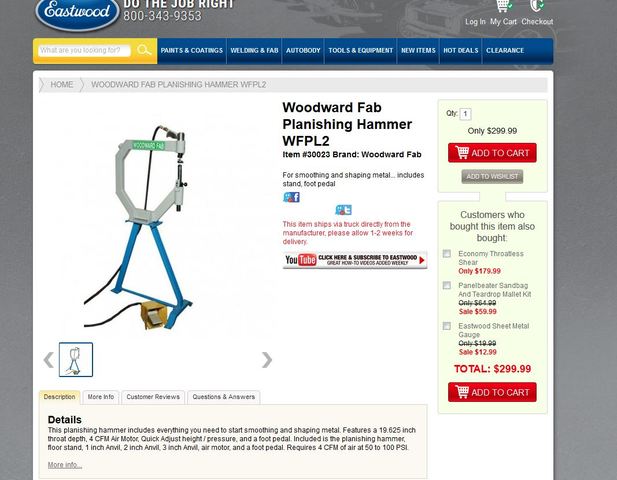

Ed Kennell 44,992 #37 Posted March 7, 2015 Use a planishing hammer Got a pic of this hammer ? Share this post Link to post Share on other sites
pfrederi 19,940 #38 Posted March 7, 2015 Got a pic of this hammer ? 1 Share this post Link to post Share on other sites
Ed Kennell 44,992 #39 Posted March 7, 2015 I have never used one of these hammers, but I am having trouble understanding how any hammering of metal will cause it to shrink. Logic tells me hammering the metal would make it thinner and therefore increase the surface area instead of shrinking it. I am not questioning if it works, I just need help to understand how it works. Share this post Link to post Share on other sites
Ed Kennell 44,992 #42 Posted March 7, 2015 Thanks Craig. The shrinking disc was all new to me and very interesting. Takes a real artist to do that kind of repair without resorting to Bondo or lead. Share this post Link to post Share on other sites

Road-Track 39 #45 Posted March 8, 2015 (edited) The best way is to use a shrinking hammer and a hardwood dolly. You will not harden the metal. In England the the masters use a wooden stump to shape and shrink metal. If it is good enough for Rolls Royce it's good enough for Wheelhorse. Edited March 8, 2015 by Road-Track 1 Share this post Link to post Share on other sites
