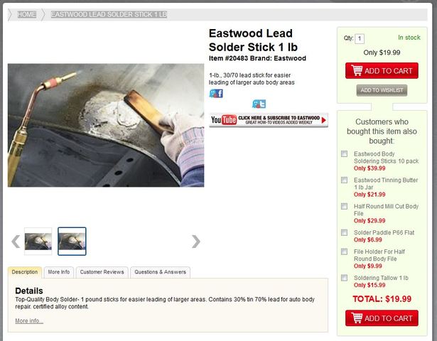

Bert 805 #13 Posted February 22, 2015 I do not know much about this, and have not really tried it, but , depending where the holes are...a propane torch and some lead (with some wax as flux) could do the trick. In the old days (before bondo) body guys used lead as a filler and torched and filed to make things right. It does depend on the thickness of the steel, but you are not using a lot of heat to melt lead...but you do have to get the steel hot enough to accept the bond. It is a lot cooler then welding...kind of like brazing...but cooler then that. Think of it like solder...to a point. I have done a lot of lead work...it is easy to work with. Another option would be some type of bondo. Using plastic wrap taped on the back side and filling the hole...sanding...etc... boom, shak-a-la-ka I helped my brother sand and prep an on old VW bug that had lead filler in it, never really gave it a thought? Is it still available for filler? Share this post Link to post Share on other sites
stevasaurus 23,884 #14 Posted February 22, 2015 (edited) A piece of soft copper tubing...hammered flat will work for what they are saying above. That type of lead stick is probably not available anymore. But you can still find lead in plumbing soldier, I might try a package of lead fishing weights...should be able to find a close size for the hole you are trying to fill. Where is the hole at?? This could make a difference...if it is like where lights were mounted on a hood...I would try the lead. If it is on the surface of the hood...I would go with the bondo. Edited February 22, 2015 by stevasaurus 2 Share this post Link to post Share on other sites

pfrederi 21,306 #21 Posted February 22, 2015 (edited) Auto body lead is still used. www.eastwood.com Edited February 22, 2015 by pfrederi 3 Share this post Link to post Share on other sites
