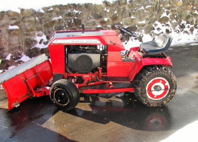

AMC RULES 37,259 #4 Posted February 19, 2015 I've got one with a half foot of stainless bolted to the top of it here. 3 Share this post Link to post Share on other sites
Hodge71 691 #5 Posted February 19, 2015 I've got one with a half foot of stainless bolted to the top of it here. I spy a snowy Workhorse...... Share this post Link to post Share on other sites
wallfish 20,219 #6 Posted February 19, 2015 I solved that problem by shooting it 40 feet with a blower 8 Share this post Link to post Share on other sites
Butch 194 #7 Posted February 19, 2015 I've got one with a half foot of stainless bolted to the top of it here. AMC was that stainless put on a brake? It doesn't look flat. 1 Share this post Link to post Share on other sites
