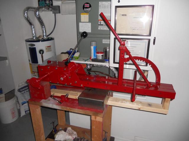

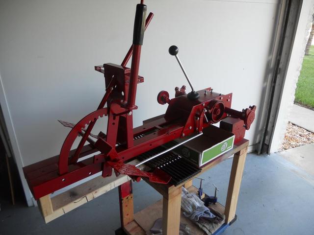

Racinbob 13,122 #3 Posted February 18, 2015 These might help. Share this post Link to post Share on other sites

Racinbob 13,122 #5 Posted February 18, 2015 (edited) It's a bearing. As pictured it's being held in place at approx. the location of where it would be if was tensioning the belt, maybe a little higher. I measured the rod to the outside of the trunnions. The spring goes on the little tab welded on the frame but I don't have a spring yet. Edited February 18, 2015 by Racinbob Share this post Link to post Share on other sites

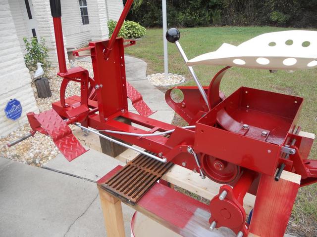

Racinbob 13,122 #6 Posted February 18, 2015 Found this one with maybe better detail. Share this post Link to post Share on other sites
