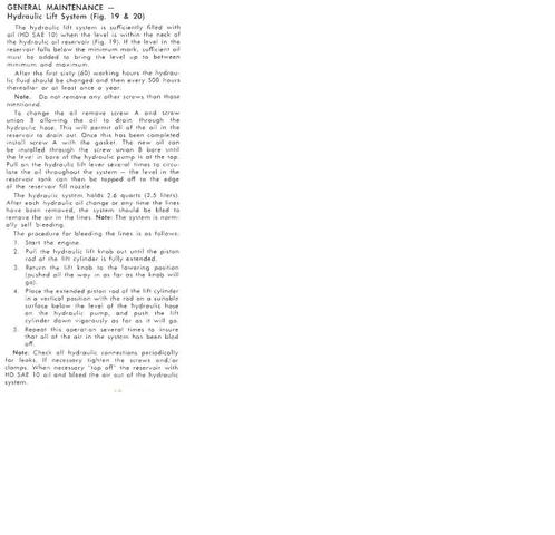

botzitaliano 37 #1 Posted February 15, 2015 Quick question. In the front of my d250 i have the hydro fluid tank. When i open it i dont see any fluid. I know i have to add, but when do i stop adding? I dont see any fill lines or anything. Also just to be sure the hydro fluid to use is HD sae 10?? Thanks in advance for your help. Im very new to all this and want to be sure not to screw anything up. Share this post Link to post Share on other sites
gwest_ca-(File Mod) 12,533 #2 Posted February 15, 2015 Found this in the 1976-1977 operator manual 1978 on used another manual. What year do you have? or go into the manuals and do a search for D-250. When the results come up click on Submission date and change it to Title. Then change the Descending order to Ascending order. Garry Share this post Link to post Share on other sites
