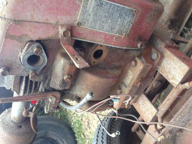

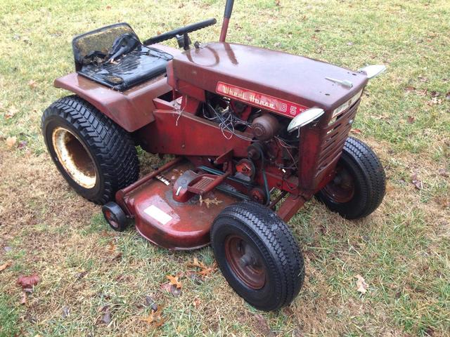

Bobster 19 #1 Posted February 15, 2015 Hey gang, I just traded for a 857 in really poor shop. The carb was in a box with a carb kit. The fuel pump was in the box also. It look trashed. Can I start it with out the pump if I just block off the hole. Also need a coil. Don't have any idea of the condition of the motor, so I guess I just need to start it and see. Kinda wish I could trade it for a running Wheel Horse to play with.... Share this post Link to post Share on other sites
boovuc 1,090 #2 Posted February 15, 2015 You will feel a whole lot better about yourself when you can bring that tractor from it's death bed to running and working. What you can do right now are some basic things. First is to test for spark If you have spark, then you are good to go to tackle the carb. You can run it without the fuel pump. I would mount the old pump over the hole when your ready to try out the carb. I use a small gas tank from a mower for testing engines out that the fuel pumps are toast. Don't drive it until you check out the transmission first. That 857 looks great. 48 years worth of history and patina on that tractor. 1 Share this post Link to post Share on other sites

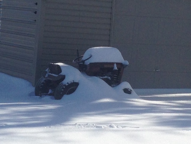

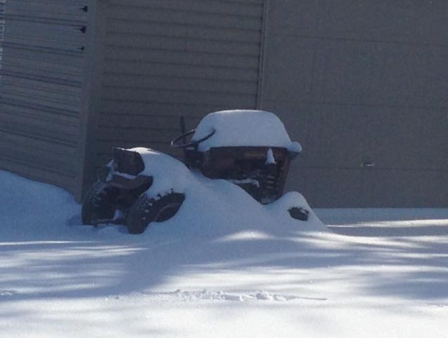

Bobster 19 #18 Posted February 17, 2015 This is what she looks like today... Share this post Link to post Share on other sites
boovuc 1,090 #19 Posted February 18, 2015 I would knock the snow off of it to try to keep as much moisture from possibly getting into the transmission as possible. Then throw some plastic over it. If you look at the shifter where it goes into the transmission case, you'll see the rubber boot that is no doubt in bad shape and will allow water into the case. Share this post Link to post Share on other sites
Bobster 19 #20 Posted February 19, 2015 I meant to have it inside the garage before this snow came. My bad. Hope to get it in this weekend...... Share this post Link to post Share on other sites

stevasaurus 23,753 #22 Posted February 20, 2015 If you use the old gasket, torque to regular specs. Also, you can use a credit card and a shop vac to scrape off any carbon under the head. The 857 is a great tractor, as you find out. That picture of it in the snow like that is probably the last time...save that picture. The next time that horse sees snow...it will be plowing your drive way. I know...I have an 857. 4 Share this post Link to post Share on other sites
