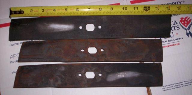

groundhog47 448 #4 Posted February 15, 2015 (edited) The 8969 set has the 9188 (2ea outer 12") and 9187 (1ea middle 14") double d blades: Blade chart shows 8969 and 101335 for 77yr 75-36xr01-02, almost sure still have both sets in ad. Also Toro parts shows if you put in 9188 supercedes to 8969 set and lists the 9187 also but on older model. Then 8969 shows on blade chart. Edited February 15, 2015 by groundhog47 Share this post Link to post Share on other sites

doc724 927 #6 Posted February 15, 2015 I had a similar problem a couple of years ago. I did not want to pay the Toro cost, so I hunted around and found a suitable blade from Du-Cuts Power Equipment Warehouse. The only difference is that the hole in the middle is round, not the double D as shown in groundhog47's pix. As we all know, the round hole works just fine as the double D has been omitted since 1979 and the friction of the nut and washer clamping them tight is sufficient. Share this post Link to post Share on other sites
